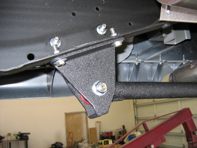

Any pictures of the "right" way to install these front brackets. I've looked at it both ways and still am not sure which is correct.

I did something close to this....I installed the rear section on jackstands, then I lowered the truck to the ground, then CLAMPED the brackets on the frame and marked the holes.
I raised the rear end back up with the bars clamped, to give me more room to drill, and they didn't move at all, so I guess you would be safe to just support the rear axle only (no frame) with stands, and install them completely, and then tighten the rod bolts when you lower the truck to the ground to prevent binding on the bushings.
I will post a pic of mine when I get home if nobody beats me to it.

Old Apr 27, 2005 | 05:03 PM

Old Apr 27, 2005 | 05:41 PM

I thought that was 180 out?
Doesn't really matter though.
Bob

Thanks for the pics. Now I have photos showing the bracket both ways... lol
I guess it doesn't really matter as long as they are secure.
Scott

I have my front brackets mounted the same way as the ones in the photo (it made sense to me when I was installing them) . . . but a few days later I was out at Johnny's shop picking up CrazyOldMan's parts and Johnny himself told me I put them on backwards.
He said it wasn't really a big deal, especially on my stock ride height GEN 1, the point is that the bottom most portion would be angled a little differently providing a little more ground clearance which isn't an issue on my truck.

Yes those photo's show the bracket is on backwards, the front bracket should have the cut portion pointing down, this will give you about 1" more ground clearence....JL
Now we know... Thanks Johnny
