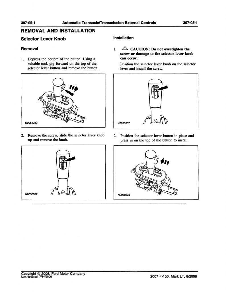

Here is a sheet for an 07...it should be the same for yours. Very easy !!

No, just the handle. After the screw is removed the handle just pulls straight up and off the lever.
