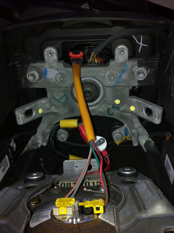

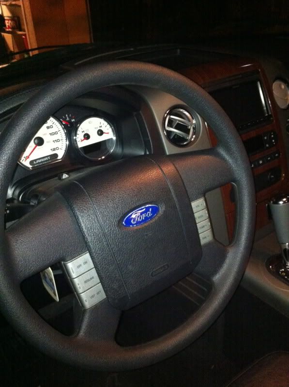

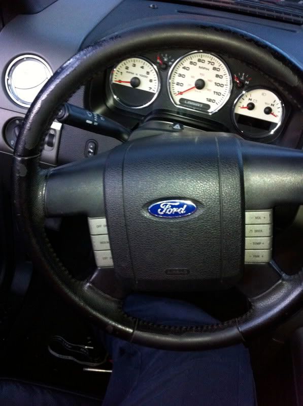

The leather steering wheel on my 05 Lariat was starting to look really bad. I picked up a OEM wheel on ebay for $40.00. I must admit that I hadnt realized that it wasn't the leather one the truck came with, but it was an OEM brand new 0 miles steering wheel that I guess comes on all the other models.
Heres the OE one

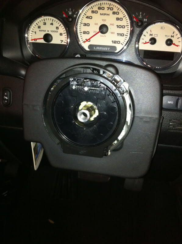

And here are a few of the install and the final look.

The swap was straight up. You'll need a two jaw pulley to make your life easier. then basically remove the 4 screws holding the rear housing and swap it over to the new one. and reverse the process to reinstall. Just incase I used a tad of blue loctite on the torx bolt that holds the wheel in place. As for using the newer style, Im not really sure. Not sure if the wiring will work..
