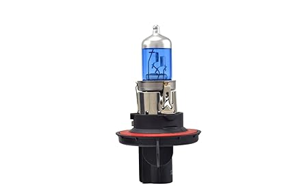

I've been able to replace the turn signals without taking the lamp housings off. But that is it. No way to change the H13 low/high beam lamp.
For what it's worth, I have used these in my truck. They worked great for me.
Roll over image to zoom in
HELLA H71071052 Optilux XB Series H13 9008 Xenon White Halogen Bulbs, 12V, 100/80W 2 Pack
by Optilux
3.5 out of 5 stars 22 customer reviews
Amazon'sChoicefor "hella h13"Price:$36.10 Free Shipping for Prime Members
