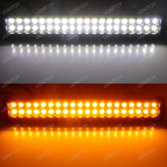

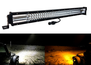

LED light bars are all over eBay, Ali-Baba, & amazon.com. Very inexpensive. And even the least effective light bar, puts out more light than your headlights. Most of them can be wired with a remote control device. This allow you to run power to the control module, control module to light bar, and keep all the wiring under the hood. No drilling holes through your fire wall, or drilling into your dashboard to install a switch.
I like the dual color LED light bars. Amber and daylight. Amber is perfect in inclement weather. Daylight temperature is great in underground parking garages, off-road, or on unlit country roads.
Prices can range from under $20, to over $100. It all depends on what type of LED technology you choose. They are almost all made in China. Probably from the same handful of factories in Shenzhen.
