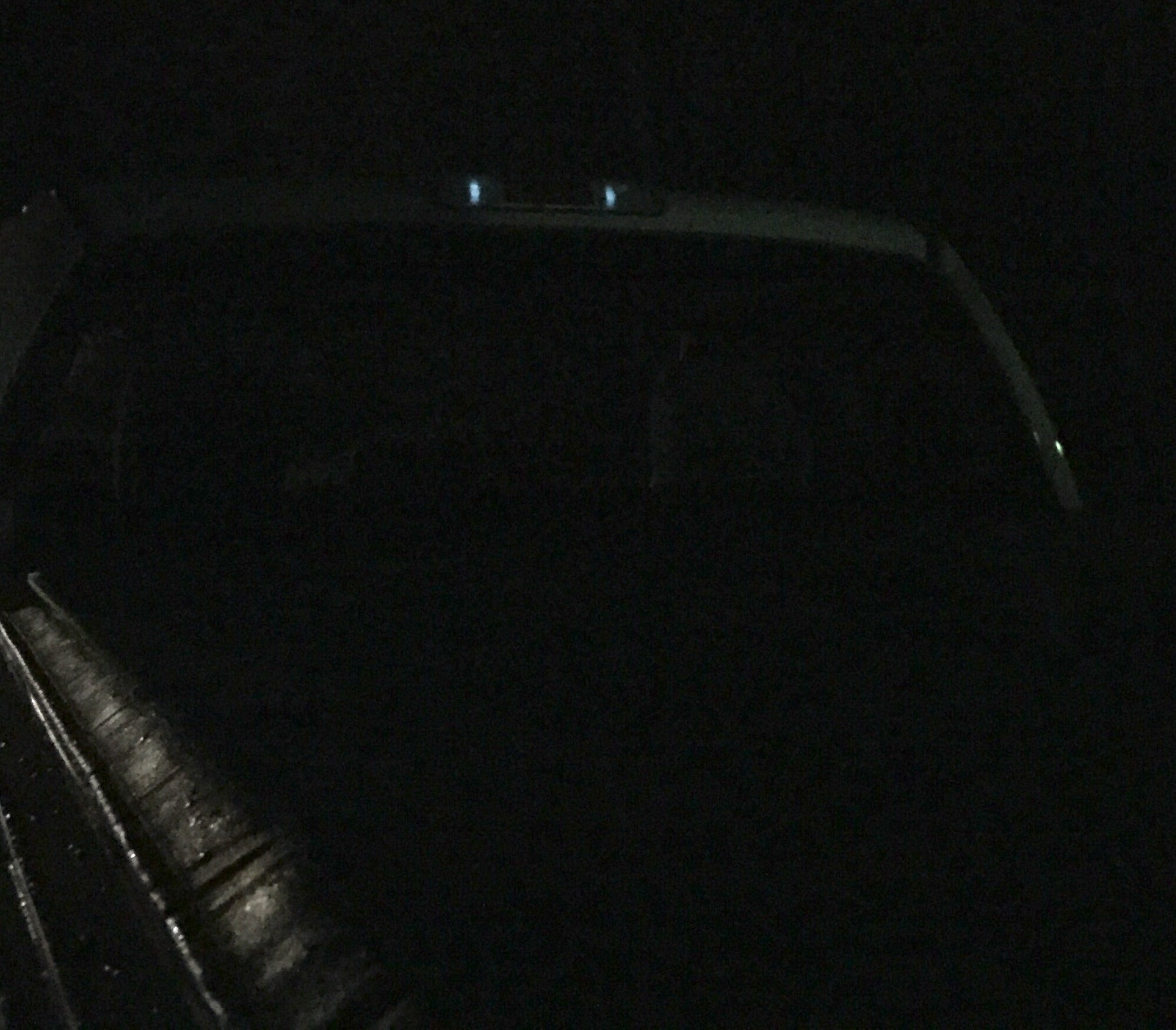

I do not have cruse. I've already gone with LED's in the 3rd brake light and cargo. No problems. It's just weird, because obviously, even when the vehicle and lights are off, there's still a very small amount of power going to the sockets which causes the LED's to glow very slightly. I spoke with someone at superbrightleds and they said its normal, and not an issue.
Looks weird though, huh?

I kinda like it, lol.
A load resistor will address that too.
