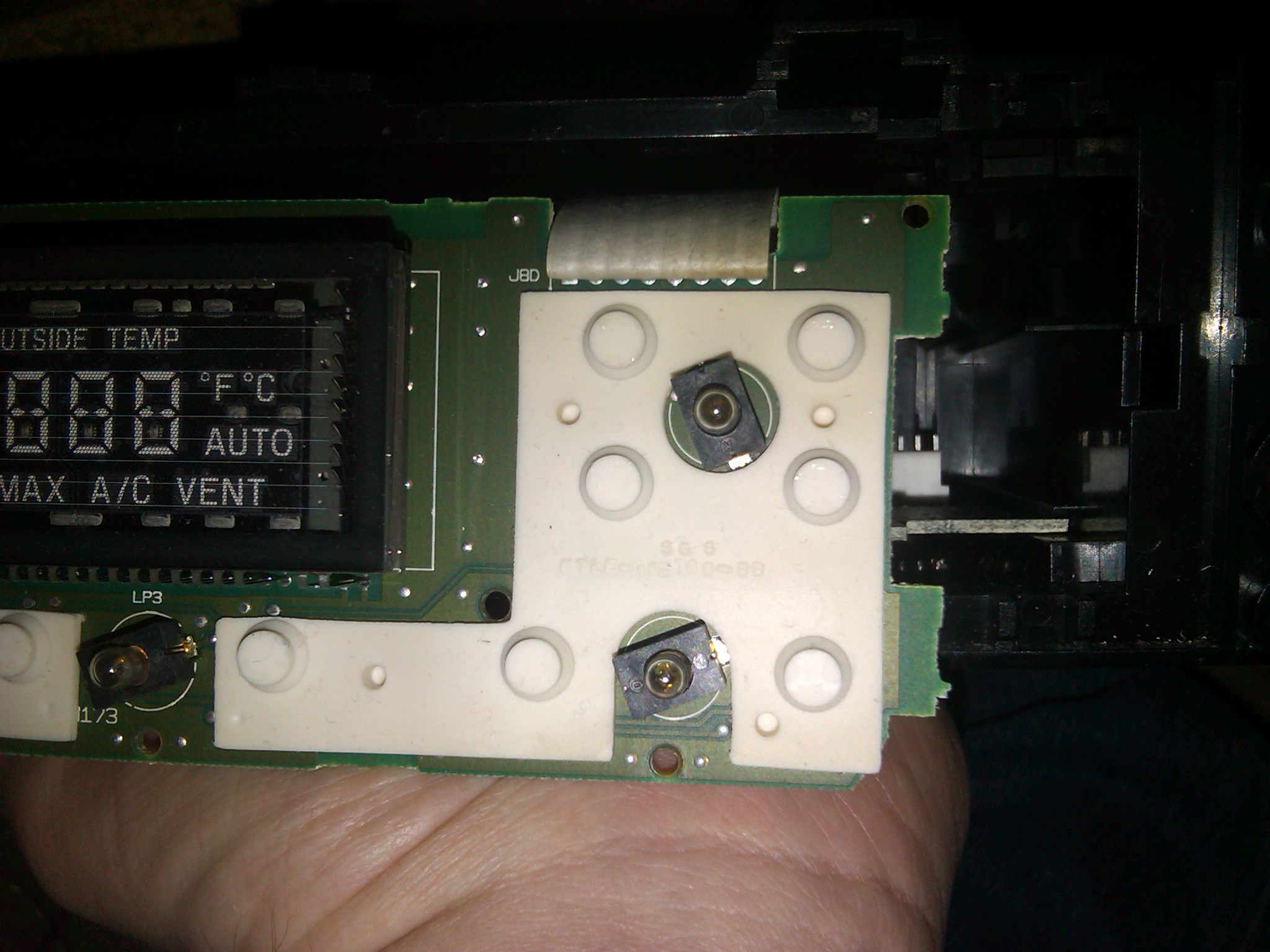

While I have the ETAC out I would like to replace the burnt out lights. These aren't like the lights in the manual controls. I have searched and searched and cannot find an article that shows how to replace the lights on the ETAC.

might want to just get a new unit....the bulbs are a PIA....glued into plastic blocks.....it can be done but one needs to be good with glueing and soldering....
I think these are the bulbs.... http://www.radioshack.com/product/in...ductId=2103780

They aren't that hard....just meticulous. The post above says it all

Thanks. I will pick up some bulbs at Radio Shack this weekend and give it a shot.

Got it done. It wasn't all that bad since I already had the unit out replacing the o rings in the accuators to fix the defrost only air.
