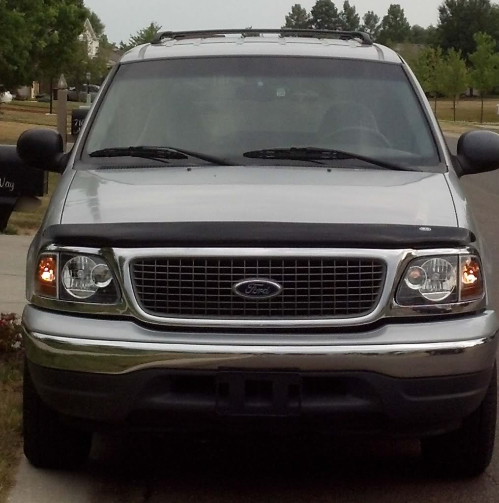

Hey guys,
I am disappointed with the stock low beams. The high beams are pretty fantastic! The headlamps came with some Phillips bulbs which really seem a little weak. They probably are not, I just notice the difference moving from my luxury sedan with real $$$ projectors into the Expy.
So, I went to Wal-Market... Man, I hate that place... Anyway, they were selling Silverstar Ultras for $48 a pair. The light appears more white whereas the Phillips bulbs have an amber tint, but they really do not seem any brighter... In fact, there is one Phillips and one Sylvania in the headlights right now and other than the "temperature" of the bulbs, there does not seem to be much of a difference. I am not sure it is worth the price to keep them.... I will check the bulb seating, but it is just not that hard to get it right, I think.... The problem may be in the reflector design itself or the aim.

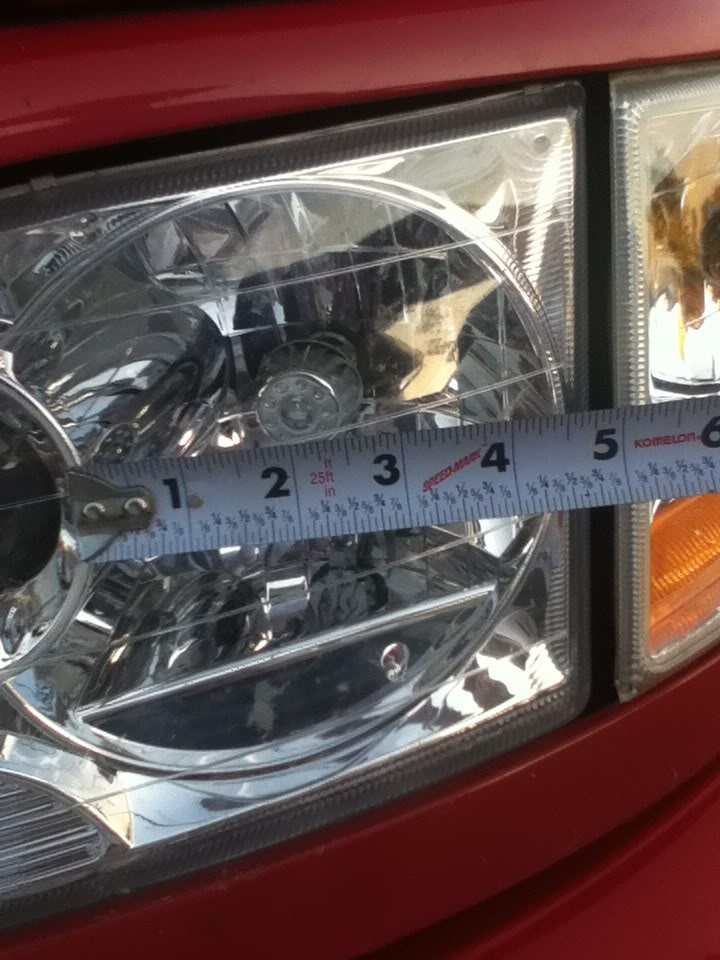

A projector WILL fit in the reflector. You will have to trim down the shroud but that's not hard. If any of your guys can get a lens diameter, I can suggest a projector to swap out with
An E55 (the biggest) will easily fit in there. If you guys are serious about swapping out that high beam projector, go on over to www.hidplanet.com, they can help you with what will fit and whatnot.
