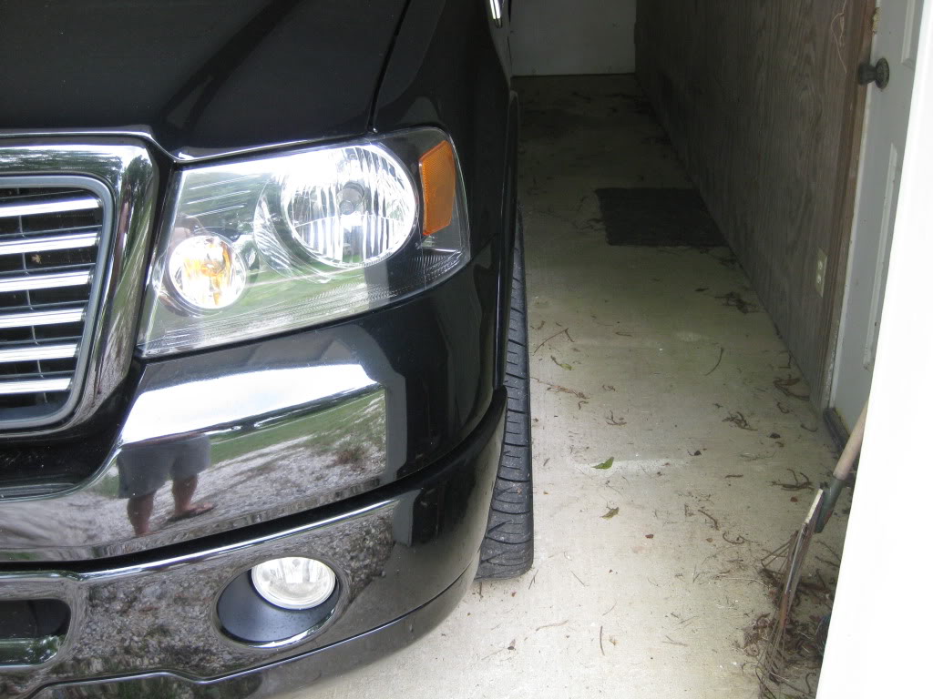

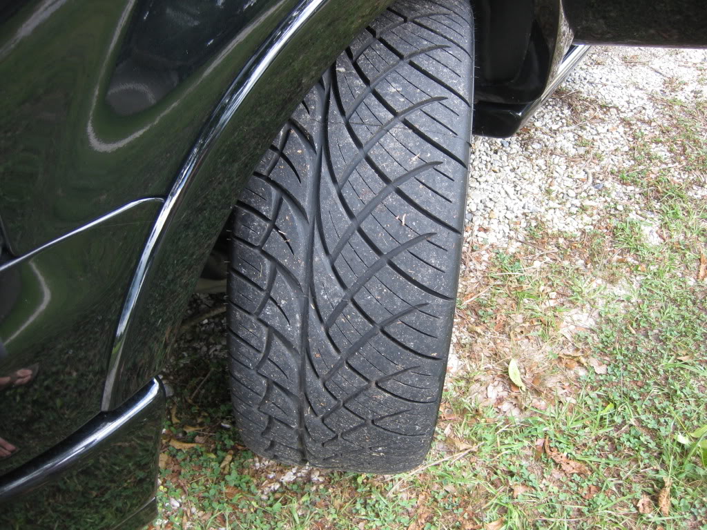

I have 305-40-22 on my 07 Harely with stock 22s
Granted yours is a 2010 rim size may be different. I have a little over 1500 miles on them and they haven't shown any irregular wear. I drove from MS to Washington D.C. to NC a week after putting them on. I love them!!! Nitto 420S 305/40/22
