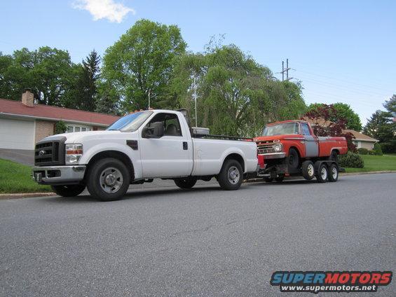

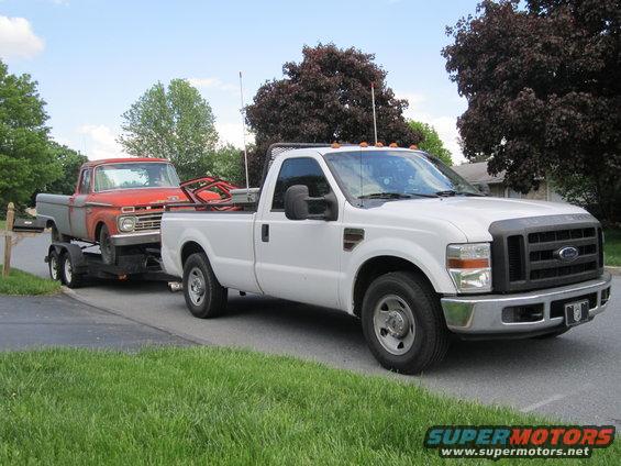

Headed up there to Highspire PA with a friend of mine to help load and survey the damage. Guys shop did burn to the ground, but the truck was far enough away to not damage it. Only things lost were most of the trim, battery, two tailgates (dad must have found a second better one, as I never knew about that), and ignition switch. He did have the cab mostly painted, fender rot fixed, cab corners replaced, bed floor patched, new hood primed and painted, and new doors installed, so really I just have to get it all sanded and finish coated after I swap the hoods. Not sure what that will cost me yet, but starting to look around now.

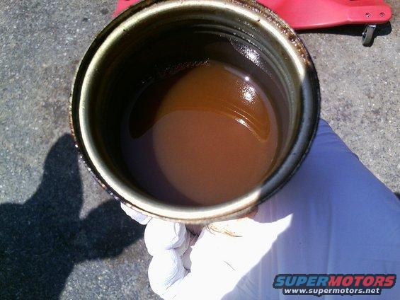

Borrowed the second easier to get to battery out of my 6.4L stroker, and after sitting most of the time, fired up and idled. Accelerator pump was clogged, but did have just enough to make it onto my trailer without the winch.
Enlisting the help of some older school knowledge, got my accelerator pump squirtin' again. The soft fuel line to the fuel pump was original Ford, and fresh gas turned it to mush with a quickness. Swapped that out, added a lawnmower style prefilter, so I can keep an eye on things. This was in the filter bowl, so I'm thinking my tank is rusting from the inside out. Might get one of those combo toolbox tank units after painted and bedlined.

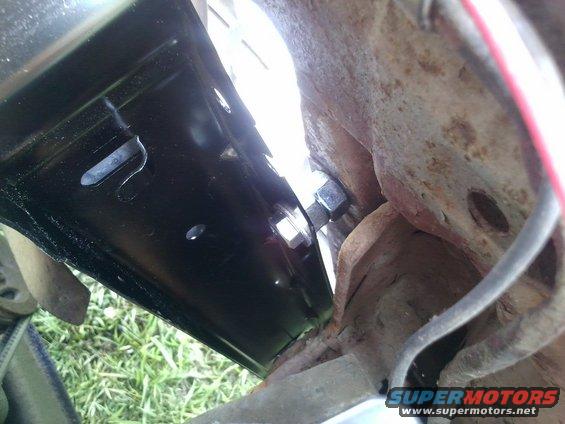

Little bit irritated at rock auto, but it is what it is. First radiator I ordered was probably my fault, but I didn't see an AC non AC option. Either way the trucks that came with AC must have shared the radiator with an F-700. Huge mammer jammer, beautifully soldered brass and copper unit. Had to send it back for not being close at all though. Second try the guy assured me it was an all metal tank unit, even though it was a lot cheaper. Course when I pick that box up it is instantly felt to be an aluminum unit with plastic tanks. Grrrrrrrrr......
Crappy part is I messed up by pulling the old falling apart factory radiator before I had opened the first box. Thought about sending this second one back, but just hit with the notice of my forth deployment next week, so gotta get this thing mobile to get insured, tagged, and put in storage.
Then my day gets more irritated when putting this stupid plastic thing in. Both brackets are flipped so the flanges are not on the right sides, but was able to unbolt everything and flip to the right direction. Almost. Now there is no room at the top of the core support for the wiring to run across. Grrrrrrrrr......
So as much as it pains me to hack job it, used longer bolts and nuts as spacers.
Home free? Nope. Top hose outlet on this stupid plastic tank is 1 3/4" wide, not 2" like the hoses I have, or like any book says it should be.
Napa's closed and the sun is going down, but the dude at autozone actually wasn't a waste of space and looked all the racks to see if there was a hose 90ish degrees with 2" on one end and 1 3/4" on the other. Not that lucky of course, but came up with a temporary plan of paid 15 bucks for a random Toyota hose to cut a little bit of the 1 3/4" off to cheat on the radiator and clamp the ******* off the 2" hose I had over that.
Filled up, pressurized, bumbled around the farm a little bit, and I'll take it to the gas station tomorrow before putting in storage until the unknown time when I get back from fun in the sand and sun.
