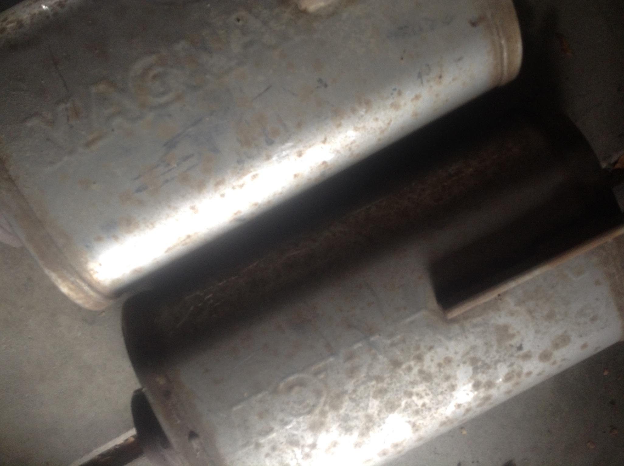

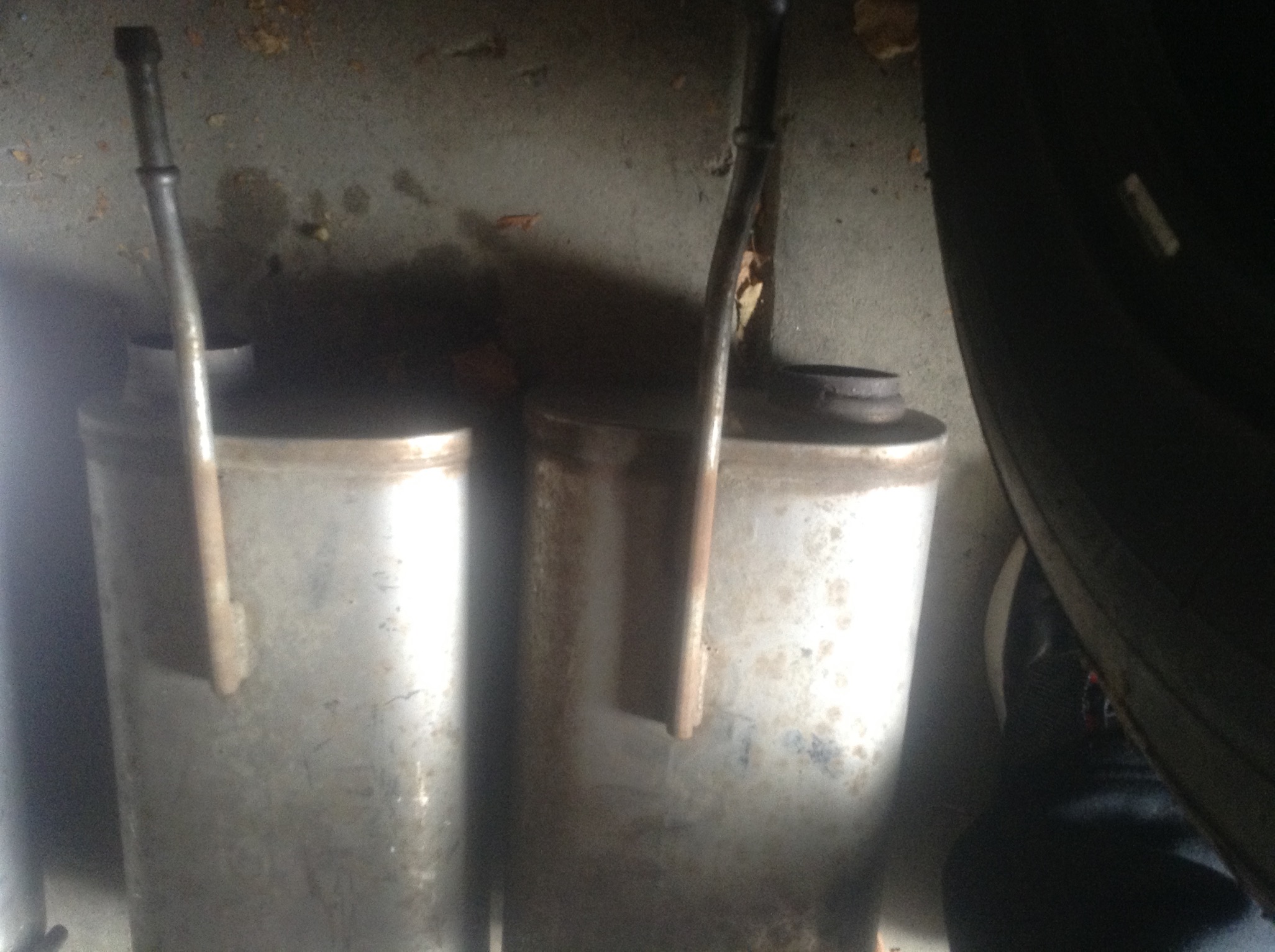

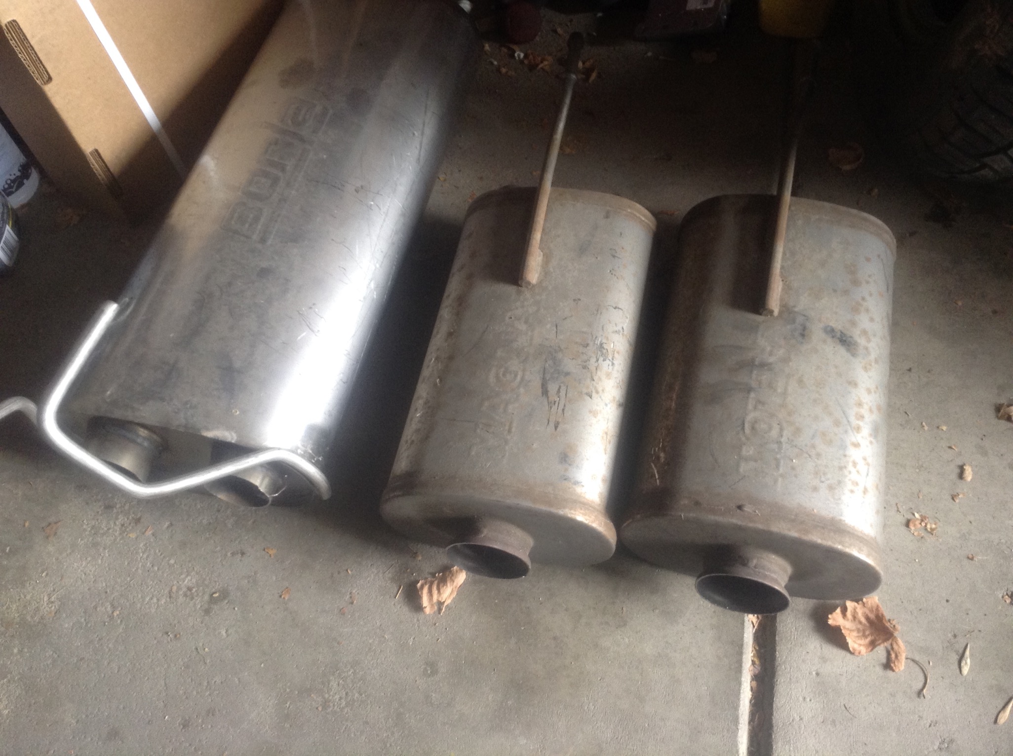

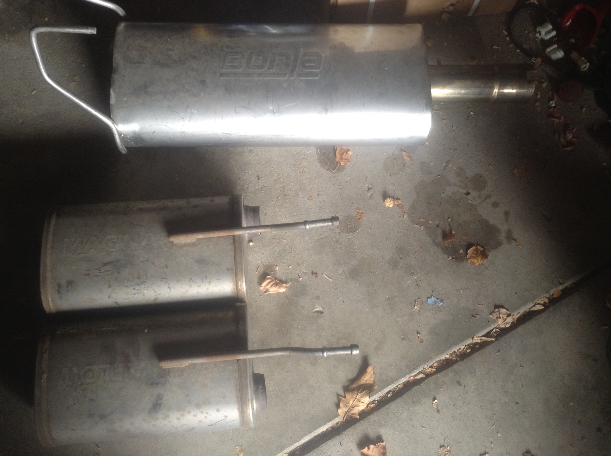

Hello and first I gotta say I got these two setups for a combined $90 via craigslist. But I don't know which would be better. I have a borla 3" SI and 2.5" DO, and other setup I have 2 magnaflow mufflers both 2.5" SI and 2.5" SO. Borla appears to be in slight better shape surface wise and ***** setupsa are straight through design. I currently have a magnaflow SISO 2.5" on it now and it have rotted through and must be replaced. I think I'm facing a time I gotta replace my cats and o2 sensors so I'd like to do it all at once if I can. I have a supercharger setup to install someday but I do understand I have a heavy truck that I don't race just like having the power so chasing every pony isn't that important to me. Thank you for all suggestions, info, and opinions in advance.

If you use both Magnaflows, you will need a X-pipe.

I personally like Borla the best. And they are built with 304ss and will last forever. I think most magnaflow are 409ss.
the Borla will be quieter cause of the size, but the magnaflows will need a X pipe for proper duals.

Okay i finally made a decision, very beneficial too! Im gonna use the borla muffler but in reverse of what we use to as in dual in and single out. Since im replacing my cats also at the same time I'll put new 2.5" tubing exit them straight to the muffler. The muffler itself will act as Y pipe too as i found these designed to be reversable if needed. It'll exit out to a 3" outlet. My exhaust tip will exit out passenger side front of rear wheel as i think it looks alot better that way from a lowered truck and i can easily see myself damaging tailpipes behind the rear wheels more frequently.
I wanted to do dual exit but there is no easy or efficient way to get a tip going out to the driver side with the gas tank in the way. I have heard alot of stories lately about magnaflows rusting out....and its happened to me aswell so borla won me over in this battle
