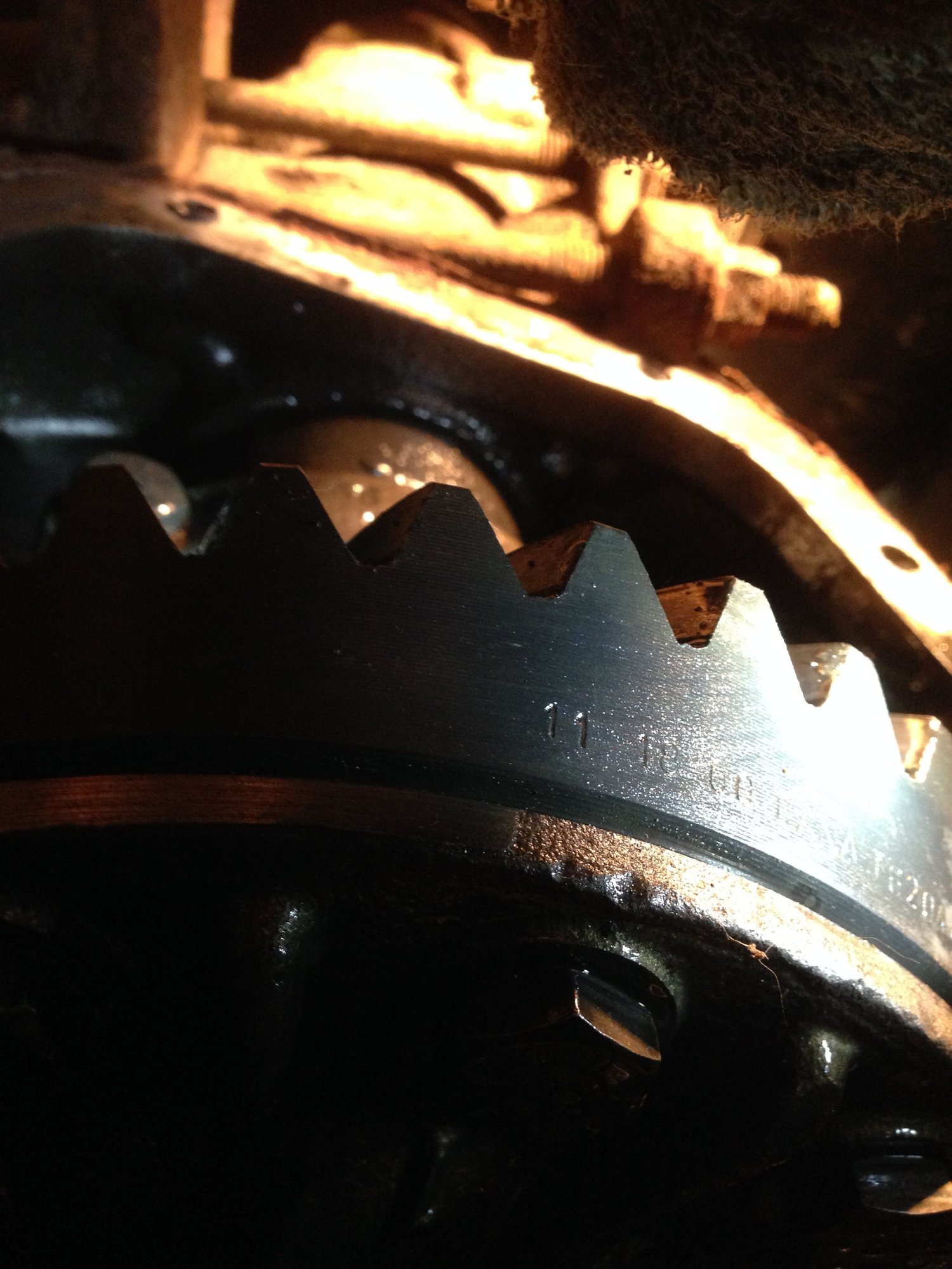

Tore it apart today and the pinion is eating away at the carrier... fun
These numbers are on the ring gear: 056 11 18 00 DANA T62048 1F 8L380 41-10
Any idiot knows the 41-10 is 41 teeth ring gear 10 tooth pinion....41/10=4.10 ratio.
What do the other numbers mean? They are stamped into the ring gear
thanks!!
