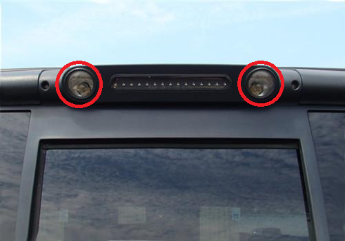

I have an issue with my truck, I didn't notice when it started, but my dome light stays on and my third brake light stays on as if I'm in reverse. Does anyone know what the issue could be? I noticed when I tap around the area of the dome light, it'll turn on and off.
When you say third brake light you mean the cargo lamp ?
- White bulb not the red lens ones.
If this is the cargo lamp, that is part of the interior lamp circuit, could be a few things.

1. This is what's on:
It shuts off, I just don't know when. Once I open the truck door, it comes on and stays on.

1. That is the cargo lamps, they go on with the interior lamps.
- How is this installed ? Is it spliced in or was it a factory connector ?
2. The same interior lamps should be on when the cargo lamp is on.
- Any other modifications to the truck ( i.e. not factory ) ?
