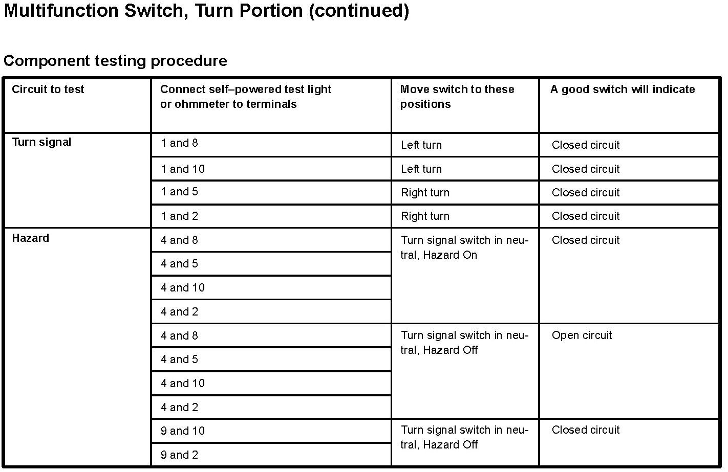

Try either the turn signal multi-switch in the steering wheel or the plug going into it. I replaced mine (99 F-150) and the problem persisted. Discovered it was in the molex plug fitting into the multiswitch. Several of the terminals had backed out and were making intermittent contact. I think I eventually epoxied the terminals in place from the back side of the plug as hot glue wasn't effective.
