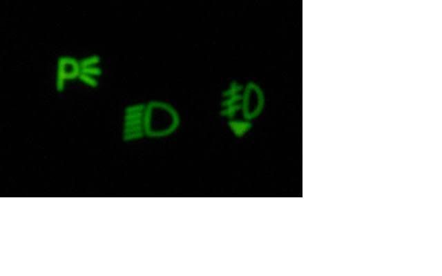

That is correct, just wanted to make sure you were looking at the correct fuses ( no note of which #9 and #27 you checked ).
One thing to keep in mind, these are the 1997 F150 EVTM pages, so there could be some difference to your Expedition.
The switch, I don't see how it was wired from the factory, but as long as it had the fog lamp icon on it, and when you pull it out, the fog lamp icon illuminates, you know you Fuse # 27 in the junction box is good.
That part is good to go, without the fog lamp relay installed.

ok i think im starting to catch on now when i turn the switch on the fog lamp icon does not come on0 so could that be power not making it to the switch

i havent had a chance to jumper the relay and yea the lights are on low beam when i pull the switch out it sounds like a click but i hoot hat any indicaters that come on when the switch is pulled out to the dog on position but i have the indicater in the center of the ****

Does your switch look like this ?
Note where it says pull for fogs
Might have this configuration, but I think this is the newer than your MY

mine looks just like that except it does not have the writing saying pull for fogs does that mean i need the switch that says that for them to work

That means you are pulling it to the 1st click to remove it, you do not have a fog lamp switch.
Ford didn't have the same switch in all models. There are 4 different models.
Main headlamp switch w/o Autolamps w/o Fog
Main headlamp switch w/o Autolamps w/ fog
Main headlamp switch w/ Autolamps w/o Fog
Main headlamp switch w/ Autolamps w/ Fog
Thought it was a bit strange that you had the switch from the factory, but no fog lamps.
