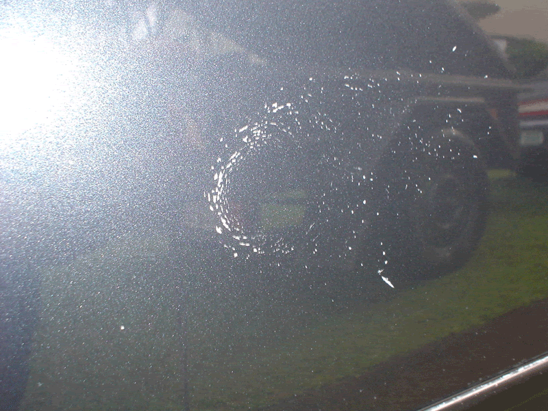

Using a high quality wax or sealant, Collinite 845, Duragloss 105, Wolfgang Deep Gloss Paint Sealant, etc..., may help a little at possibly reducing staining, but likely not much. Even permanent coatings like Opti-Coat aren't egg proof. Still better still have something on the paint than nothing. But yes, the sooner you wash it off the better. Any staining will likely need polish or compound to remove.
The paint staining isn't going to be the biggest issue though, its the fracturing (chipping) of the clear coat from the egg shell that will be the worst.
Wow, that is horrible. Fortunately these kids are mostly after each other and throw a few dozen extra throughout the neighborhood, but not with that kind of force. Biggest issue so far was missing a spot once and it left a dull area.
