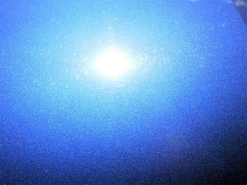

Here is a picture from Merlin on a 2009 Mustang Vista Blue Metallic.
He called it "VERY pronounced swirls and scratches "
- Wording is a subject thing, so here is his picture of the before
He did a test with the cutting / black megs MF pad and D300, and still had some faint swirls left.
He went with 2 dots of D300 and 2 dots of M105 on the Megs black MF pad and got all the defects out in a single pass.
The after is clear as glass. He did not have a picture.
