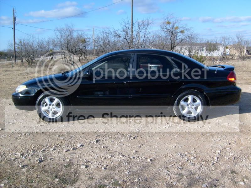

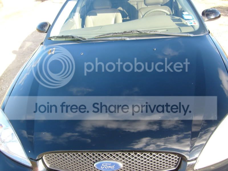

Good luck with it, when i first got my 7424xp my first vehicle was the wifes black taurus, it came out pretty good. Good luck with that M105, i didnt have any luck at all it gets to chaulky to quick and cant really work with it. I switched to the 205 and it worked great. Also i see where you got the NXT 2.0 which is good but be sure to grab some sealant also. I recommend Poorboy EXP http://www.poorboysworld.com/exp.htm. BE sure to post pics when you get started. Nothing like a nice clean black vehicle
Here are a few of the wifes taurus when i finished it. It looked worse than your truck.
