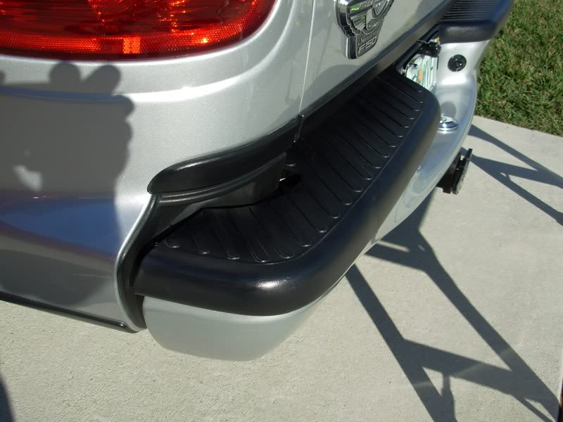

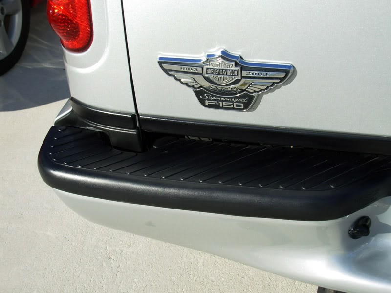

I have had excellent results with faded black plastic using Shine Supply Trim Coat Black.
On faded trim Trim Coat Black has a black dye in it and makes the exterior trim black again.
(Be sure to wear rubber gloves when using any chemicals)
After Trim Coat Black has dried (4-8 hours) I apply CQuartz Dlux Wheel & Trim Coating.
In many cases Dlux is fine but if it needs to be black again I use Trim Coat Black first.
CQuartz Dlux is my go-to product on trim. I darkens the trim and acts like a coating when dry.
I will state that IMHO it take 8-12 hours for CQuartz Dlux to dry. IMHO Dlux will lasts up to a year.
CQuartz Dlux is not a dressing it is a coating. When it's cured it's completely dry to the touch.
This is my 1-2 punch for making trim black and making it stay black.
Remember: Each product needs cure time before the next product application.
Notes: Dlux makes trim darker and has excellent longevity.
Trim Coat Black makes it black. Dlux seals the Trim Coat Black.
