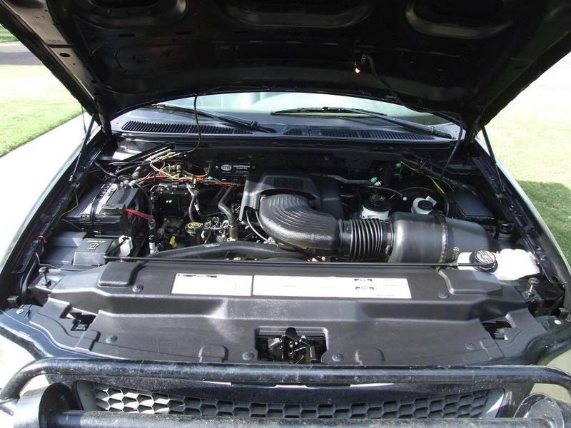

I have the same question, my truck engine compartment is pretty dirty to me (as you can tell from the picture below) and I want to clean it up a bit, just afraid I might mess something up.

It's interesting that some folks will tell you to just blast away (and they claim to never have had any problems) and others (like me) have learned our lessons. I guess you'll just have to make your own decision, but I'd suggest taking a careful look at what Jolly Green Giant has said. He's good and he ought to know. As for me, the strongest thing I use under a hood these days is a hand pump garden sprayer.
The biggest piece of advice I can share is from a conversation I had with the owner of a local Ford dealer earlier this year. He'd just fired a "detailer" for pressure washing - and screwing up - his 3rd used car. There's just too much electronic stuff under the hoods these days and if you don't do immediate damage, you're probably starting damage that will show up down the road someday.
For light soiling like yours as strange as it sounds I would recomend one of those foaming no touch tire shine sprays. Not a super slick kind. Just the normal STP foam type stuff. It does a pretty good job on just dust and such. Worth a try if you're super worried.
Size:  24.8 KB that BLUE WIRE has got to get moved
Old Dec 25, 2009 | 10:21 AM
f150fella08's Avatar
Posts: 4,637
From: Pittsburg, Texas
hahaha yea you need to run that AMP wire a little better!!!
and you think thats nasty!? then you dont wanna see mine
see post 5..im running a close second!
