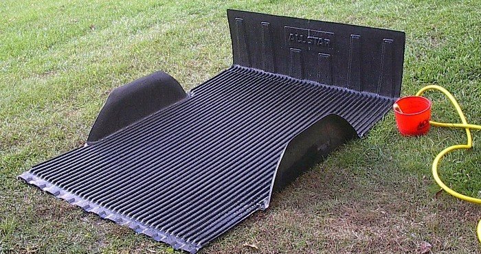

My F-side has a Line-X PO had done, also a cover and sits in a carport …. but I wanted to protect the permanent bed surface with a sacrificial covering, so a friend gave me his cast off drop in that came out of his Chevy, I spent time with it and a sawsall, soon had floor, front wall, and fender tubs protected. I have a piece I carry that fits the tailgate so when it's down, longer load is supported too.
Good many years ago, faced rusty floor in my '77. I bought a piece 5x10 feet of sheet steel, 11 gage as I recall, cut outs with sabre-saw for fender well, …. used extra pieces to build a front wall of same, welded in place and covered in a couple gallons old paint, then put a drop in in. Still there.
