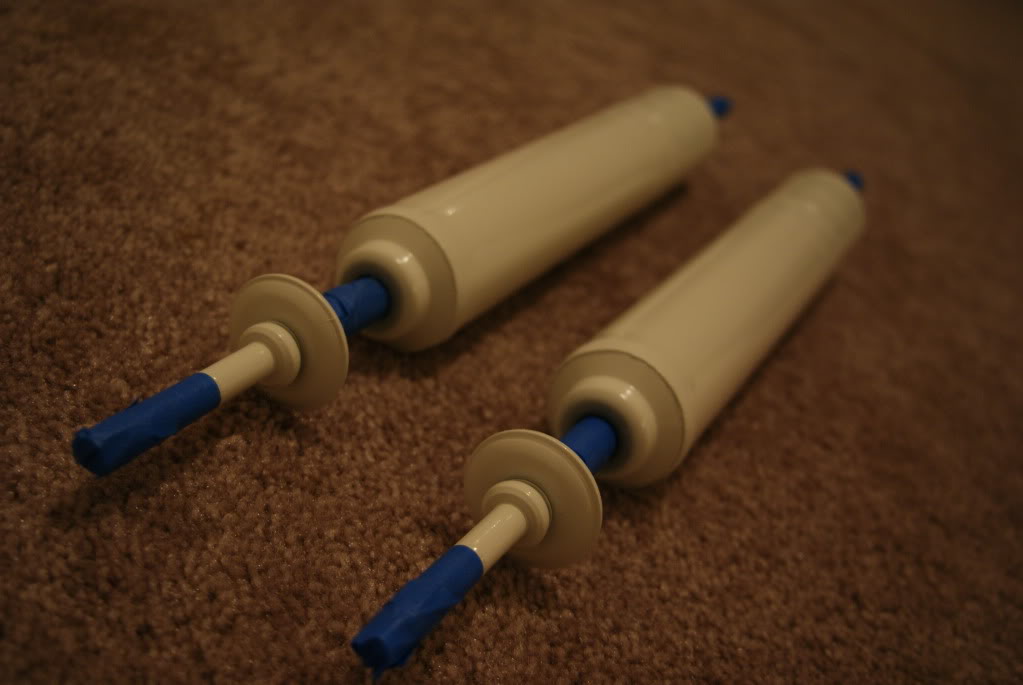

Here is the shocks and their components. The picture does not include the Backets and Hardware:

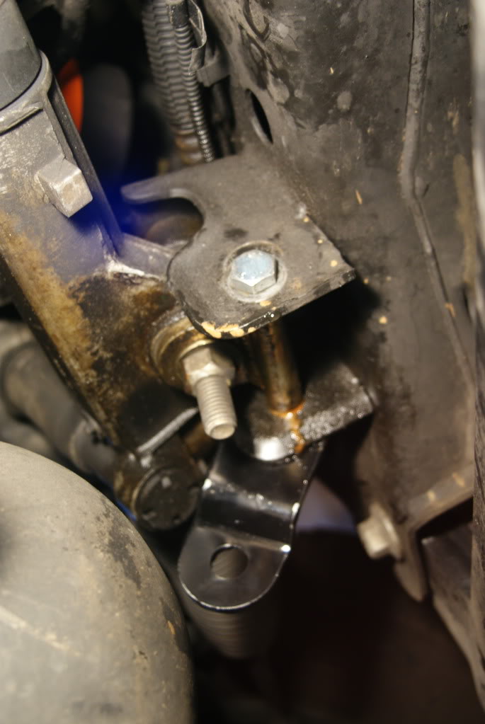

Here is a close up of the Passenger Side Rack & Pinion Bracket and a Tie-Rod Bracket all Primed:

And Now since everything is the way I wanted here is the Big Picture and also a comparison of fully extended and fully compressed:

Starting with the Drivers Side Bolt you will need two 19mm socket/wrench. Replace the stock bolt with the new 12mm x 130mm bolt provided by the kit. While removing the stock bolt you can push in the new bolt in right behind it. Once the bolt is though grab the bracket #FT30077. On the bracket there is a washer welded on one side. The side with the washer will go against the frame. The angled cut on the bracket will sit flush with the vertical side of the frame/crossmember. Slide on the also newly supplied washer and nut, then torque to 70 ft lbs. Here is the Driver Side Bolt from an underside view with the bracket and also a view from the side looking in:
Now in the instructions it states that you will have to cut out about 1 inch of the passenger side bracket. I mock'd up the steering before installing this side and I didn't see any clearance issues. So I went on with the install and all turned out well. But you may want to check before you install the passenger side just to be sure.
