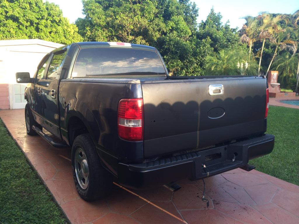

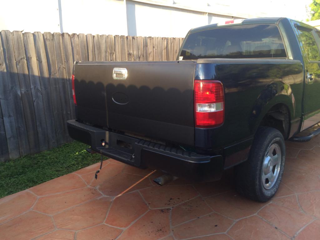

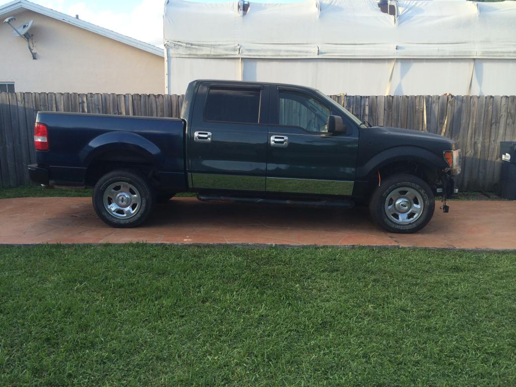

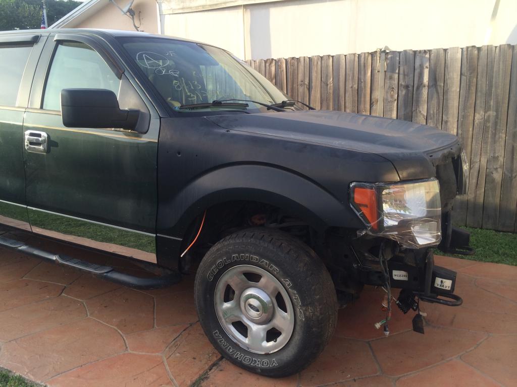

had some more time on my hands today. took care of tightening the bed down, adding the tailgate, and start on the bumper.
