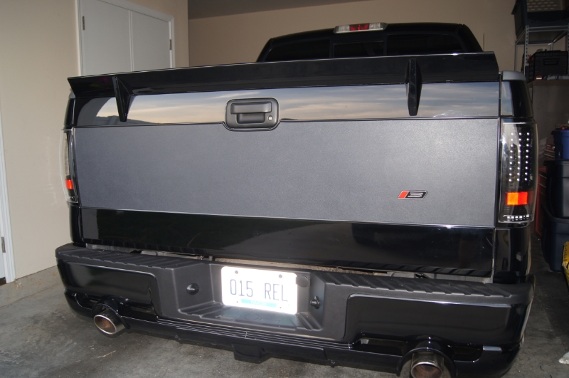

Got bored this past weekend and made a cheap tailgate panel to hide all the dents and defects on my tailgate:

Not sure about it yet. I'll keep it on for a while and see if it grows on me. What do you all think?

I think it looks really good - matches the truck very well and makes it look like a special edition.

I kinda like it bro! Nice offset, gives it a feel I can't quite describe...was thinking sorta rally-like.
Anyway- nice work.

I can't decide if like the matte or not
Looks good though either way!

Thanks! The matte looks a lot better in person. It actually matches all my other matte pieces: bumper, door handles, etc

Here's a better shot of the back:

Okay looks much better without the flash on it!

That looks really good, dare I ask for more info on how you made it? I've wanted a Saleen S331 Tailgate panel for like 5 years, and this is the closest that I have seen to one that's been custom made. Good job!
It's easy! I sourced a local plastics supplier in Louisville. I had them cut it from 1/16" ABS black plastic using dimensions I gave them. Mine has a smooth back and a textured "hair cell" front which gives it a matte appearance. I used some shears to cut out the tailgate section and put some double sided tape around the perimeter of the panel and stuck it on. Cost about 60 bucks total. The trim around it is door edge trim which you can get from Autozone, Pepboys, etc. I've since took the door edge trim off because it kept slipping out of place.
