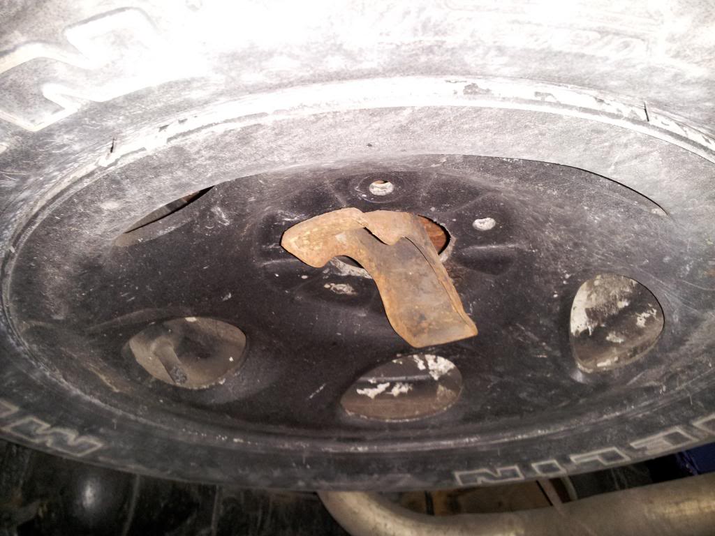

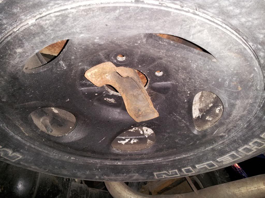

Check out the link in my sig. It explains what I did. a bit more then half way through the winter and a ton of salt and it still looks like the day I did it when I checked 2 weeks ago.
Will try to update that thread with the results.
basically sand with 40 grit and clean with paint prep cleaner.

I wouldn't use 40 grit for enamel, but the texture of bed liner needs bite to stick, also because bed liner products don't cure smooth you cant see any sanding marks. Before you do anything try it out on a small piece of scrap metal, that way you can also perfect the technique you use to spay- that determens how much texture you get and how it holds up. How you spray is very important in my experience.

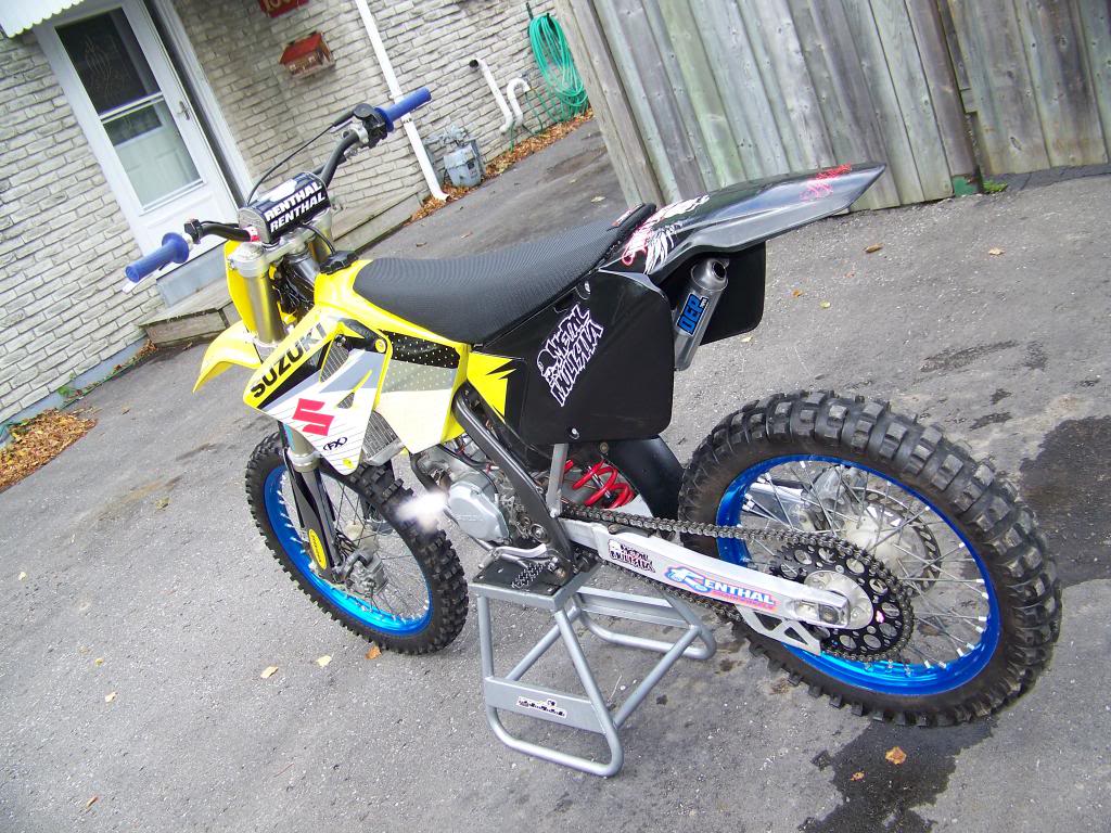

I have used spray on bedliner before. I want the least amount of texture possible for the application. The last picture on my original post shows that I bedlined the rockers of my truck and I really liked how they came out. 220 grit was what I used for the rockers. Either way I know what you are saying about how I wont notice the scuff marks and im sure I wont BUT I'm really wanting to know how the bedliner holds up and if its a self etching paint. I dont want to use a self etch primer if I dont have to and do you think that this stuff will hold up better than painting them with an enamel?Ii am not going to go that way but I have painted rims with spray bomb then used automotive clear and they turned out wicked but ended up chipping quite easily. Heres the rims I painted on my rm 125 last summer. Anodized metal cast spray can with nason automotive clear through a spray gun and compressor. Rims were brushed aluminum to begin with. They took abouse at the local mx track but Thats what my truck will be in too, the mud and ruts.

First, that bike is awesome and you did a great job on those wheels. I want to try that this summer.

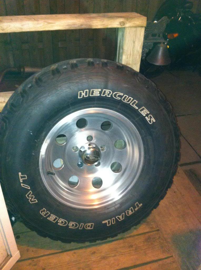

I grabbed a few quick pics for you, but it was getting dark and they're cell phone pics so sorry for the quality. I haven't been able to wash my truck since around November so the salt has been laying on it. it was never perfect but looks exactly like the day I sprayed but dirtier. I will know more in a few days when I wash it and take more pictures.

I need to do the back as I only did the face- I think doing both sides would work best for you. hopefully achieve the look your after. Your rim project will look great when done.
