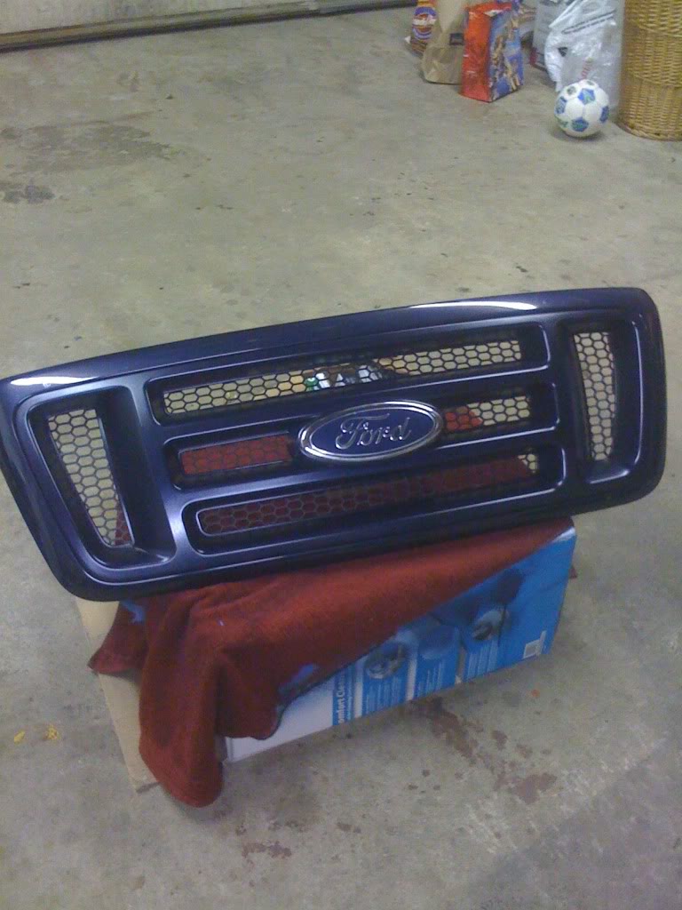

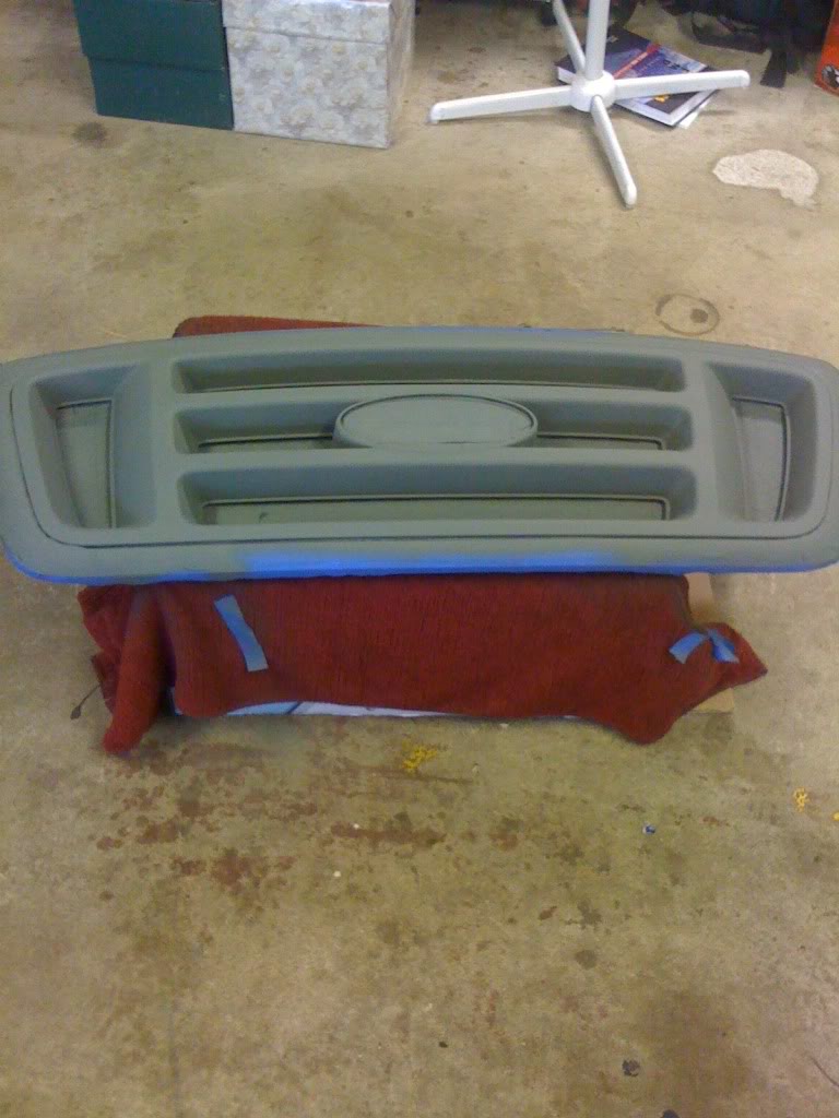

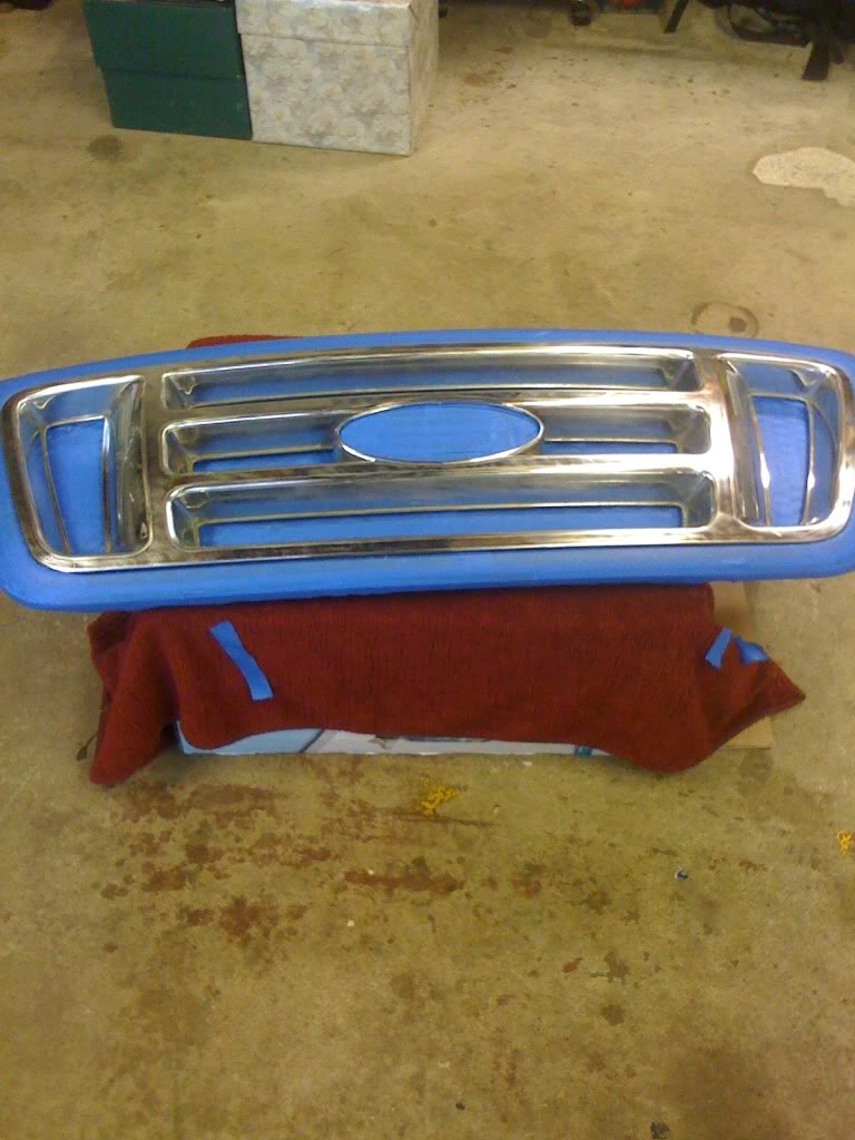

So I got sick of the faux chrome grille I had on my F-150 so I up and painted it to match the truck. If anyone is looking for a cheap alternative to whatever grille came with their truck, I'd recommend doing something like this. I took a couple pics if anyone needed a reference. The only thing I would've done differently is add another coat or two of clear coat.
Original Look

Light sanding w/ self-etching primer

Final Product

What color is it? Looks good!

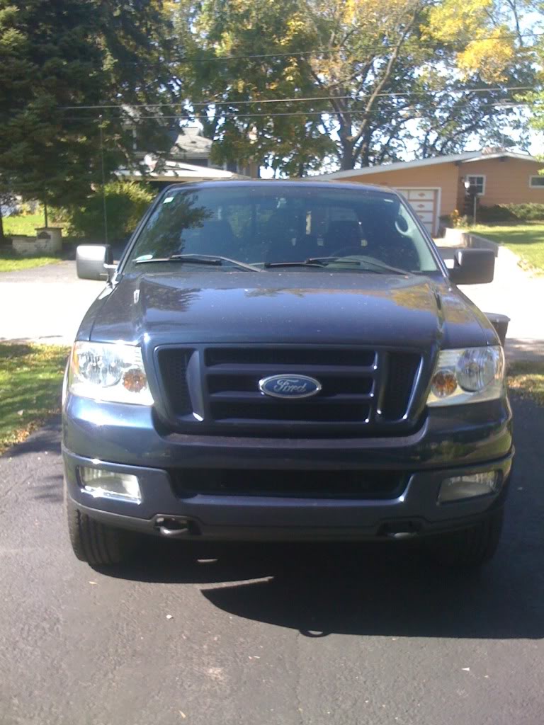

The color was True Blue. I used Duplicolor paint. They've got a good guide on their website for finding the right color to match whatever your application might be. http://www.duplicolor.com/appGuide/applicationGuide.pdf I picked it up at Autozone along with the self-etching primer and clear coat. Here's a pic of it. It was taken with an old iphone so I apologize about the crappy quality. Name:  c71fa6bd.jpg

Nice job man! Looks great

lookin great man. total 180!!!

Zeman: Grille looks awesome man! Great job
