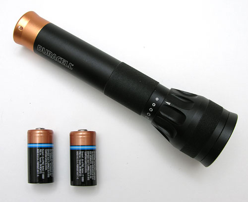

To give an example ( of LED designed reflector designed units ), this is a 500 lumen flashlight, using 3 LEDs
This is a single LED flashlight, with 160 lumen.
