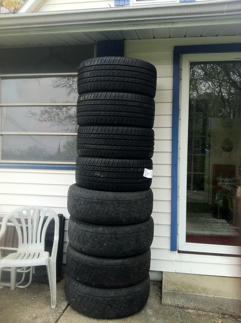

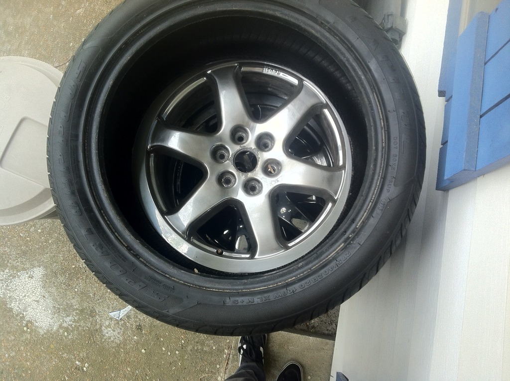

I like having the funds to work on my truck, this is a nice change of pace.
Anyway I bought some "used" tires today. If they are used at all, it's not much - they look brand new to me. All for for $280, and they (according to the internet) go for $130 each new.
275/40R20: The lower sidewall should help keep from rubbing, and bring the nose down a little more.
At this point I just need to refinish the wheels, buy the new lugs and get them mounted and balanced.
I feel like I'm going to go drifting with this stack..

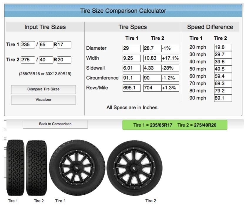

I am in my final semester before I complete my undergrad (I have about a week left) and today my brain is just fried. I am so ready to start working on the truck.. As I can't just yet, hanging out on the forums may be the best alternative.
I found this website: http://tire-size-conversion.com/tire-size-comparison/
And it looks like my conversion skills are still pretty good.
I am trying to resist the temptation until I get the new wheels on, but I am already wanting to go lower. I have the ground force 3/5 drop with springs and leafs now. I'm not asking to lay frame on static, but another inch or two would be awesome. I've been reading through the street scene forum and going back to my brain is mush today, I am lost. Anyone have any ideas?
