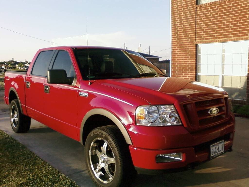

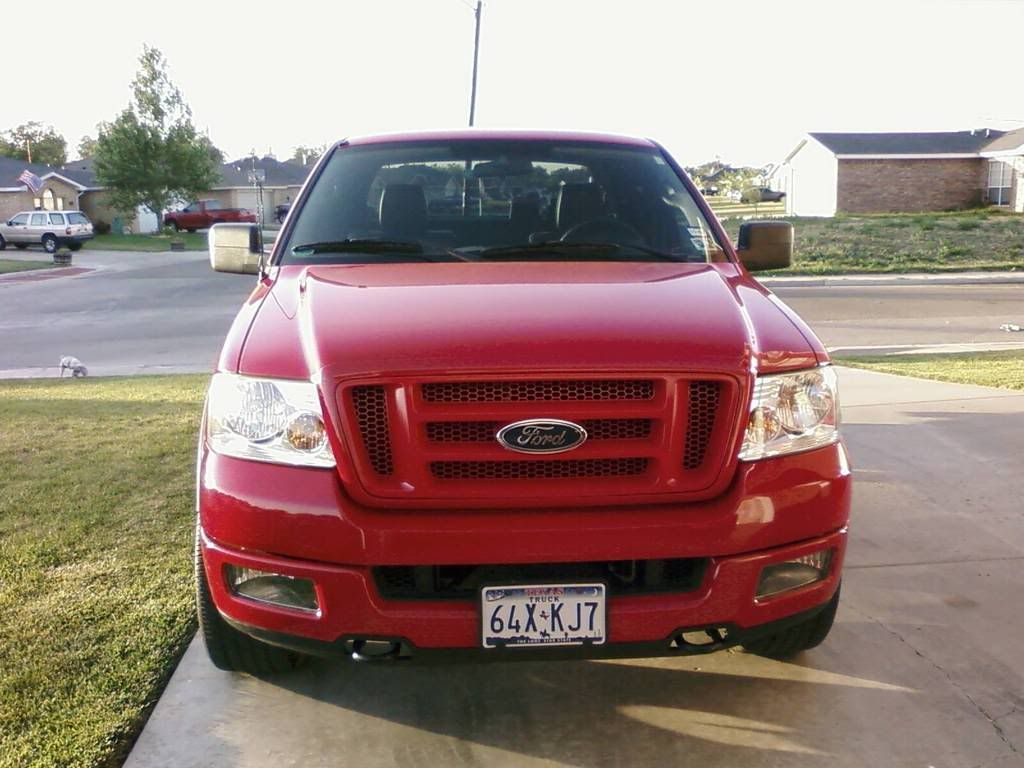

Hi there,
How does the grill look? Painted it with the knowledge gained on these forums.
I think the color is a little off in direct light, but not to bad.

Looks pretty good - welcome and nice truck

It looks great and what did you end up painting it with and what type of prep did you do to it.... I was wanting to do that to mine but make it look gloss black.

looks pretty good to me.

I removed the grill and washed it down with some degreaser. Let it dry to see if it was clean, then I scuffed it up with a green scotch pad while it was wet. let it dry, you can see if it is scuffed up enough. I used some rust-oleum plastic spray paint. I didn't use any clear yet, I plan on doing after I see how it holds up. I used almost the whole can of paint, I think 6 coats.
My next plans are to paint the cowl, fender flares and the door handles. Not sure if that will be to much red.

Looks pretty damn good for a rattle can and no clear
and you might not want to go overboard with the color? sometimes less is more

Thats kinda what I was thinking. I will at the least paint black to look new.

Yeah looks good but like said before I wouldn't go with too much red. Contrast is good... IMHO.
