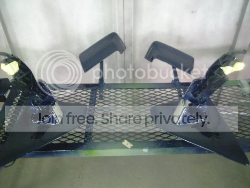

Got them from the paint shop friday afternoon and spent all day sat getting them put together.
here they are drying in the booth, almost ready to go.
and here they are back at home in about nine different peices ready to go together.
