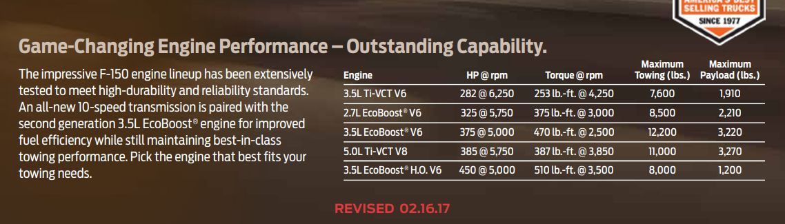

My doorjamb sticker says 1609 yet the Ford promotional flyer shows much higher; 3220 for my 2017 F-150 SC Lariat EB with Max Tow and 4x4 Off Road? Thoughts?
Old Jan 18, 2021 | 10:21 PM
Posts: 43,528
The flyer shows the max payload for a regular cab long bed 2wd with the heavy duty payload package.

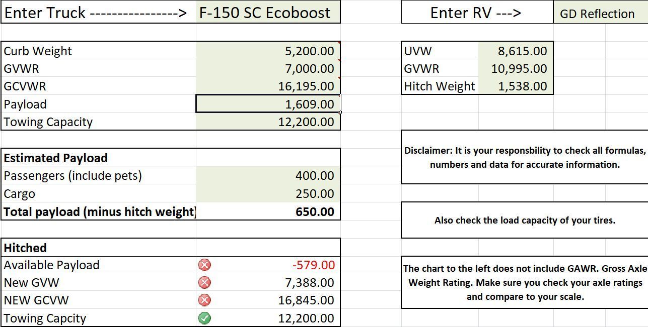

I used a variety of online calculators to determine if my 150 EB with MaxTow could handle a Grand Design Reflection 5th Wheel. Shockingly, I had input the payload based upon that flyer. I continued to educate myself and found the error and when I input the correct payload of 1609, I come up 579lbs overweight - with an empty trailer.
ERGO contacted my favorite truck salesman and after considerable discussion, bought an F-250 with a door sticker payload of 3056.
Old Jan 20, 2021 | 02:58 PM
Posts: 43,528
Good. 5th wheels with any 1/2 ton truck are not really recommended, *especially* with a 5.5' bed. You will have a much more stable tow with the F250. Make sure you use a factory brake controller, not aftermarket.
