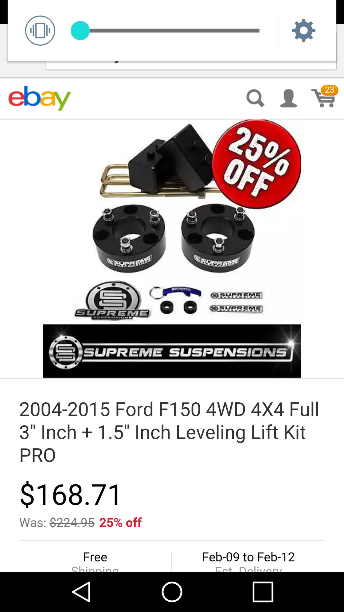

Old Feb 6, 2016 | 11:14 PM
Brad33513's Avatar
Joined: Jan 2016
Posts: 8
This leveling kit will work also..
....don't go bigger then a 00 offset.with rims or use your stock...once you put your 35 on it will sit level
