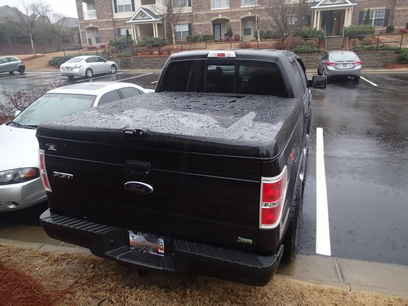

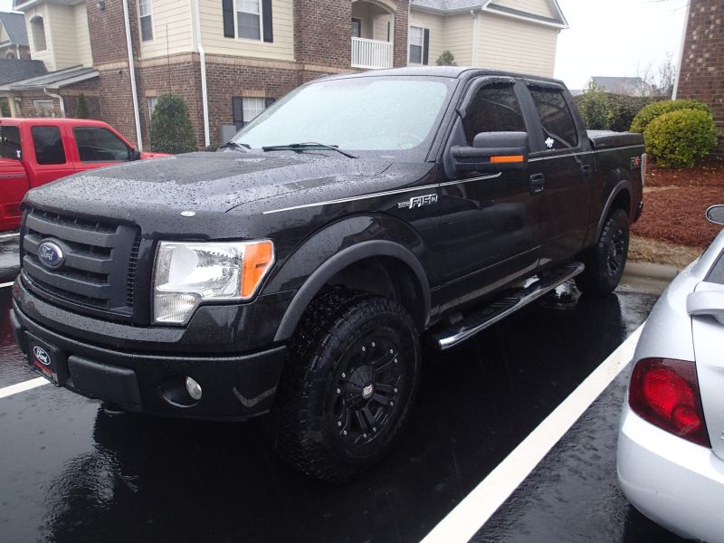

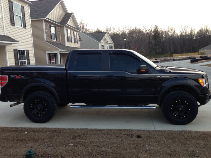

Well i traded my 2012 Charger SRT8 for my 10 FX4 cause im moving to Alaska.....Here is what iv done so far....
-Rough Country Leveling kit with performance 2.2 shocks
-34inch Nitto Terra Grappler Tires
-XD Monster Wheels
-ARE Hardtop Bed cover
On order
-Raptor SVT head/taillights
-S&B enclosed intake with snorkel to bring air from the bottom of truck

Only thing i know is that they r 18x9 and my tires are 295/70R/18...
My leveling kit i think raised the front 2.50 inches and the back 1 inch

Thats good info. Based on your stance, I'm thinking they're the +18 offset. And the size tire you have is basically the same size I have just in an 18" wheel cutout. I'm anxious to see your scoop installed. I think with that amount of level you have, you should be fine. I honestly felt if I just had an extra half in to inch of lift, I would have cleared it. So if you clear when yours is installed, that will help me decided if I want to get a slightly larger leveling kit to enable me to put the scoop back on. Can't wait to see it!

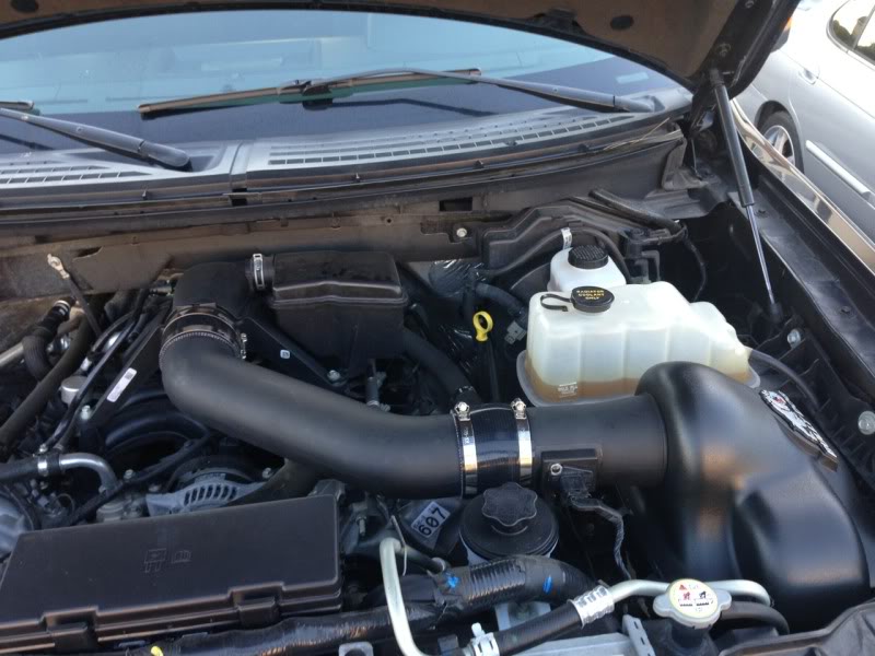

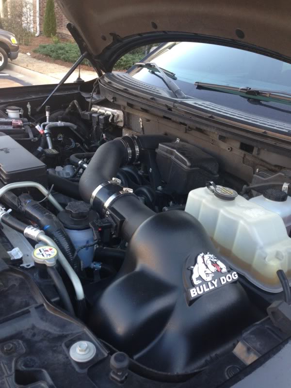

Well i got my S&B intake today and it looked like a pack of wolves destroyed it....I was very pissed....So i called the place where i bought it from and they told me not to sign for it and UPS will ship it back an not at my cost....All i had to do it print the label they emailed me and gave it to the UPS guy....So im getting a total refund....So now i noticed my neighbor had a 2011 250 and has a Bully Dog intake on it....It just replaces the top airbox cover and tube.....It is an enclosed intake with a cone filter just like the S&B intake but utilizes the stock bottom of the airbox....And also you dont need a tune for the BD because the circumference of the tube is the stock size so you can run on the stock tune.....I also asked him about running lean on his stock tune, so he showed me his dyno sheet and his A/F ratio is at a safe bracket and has been running it since 2011.....But the main reason i got an intake for my truck was just for looks cause i hate all that plastic under the hood, kinda ugly....but this is the intake i am getting now........and i got it for $199.99 + shipping

The PCM adjusts for the amount of air coming into the motor....Also the trucks from the factory come pretty Rich so you have room to not need a tune for just an intake....But according to most on this forum...Im dead wrong...but i just laugh and let it be....If it was not safe i would not do it to my truck and a big bonus is that i can put it on our dyno anytime and see where its reading at....

Got my new intake......Enclosed intake box with cone filter inside...
