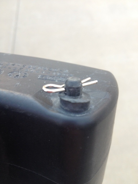

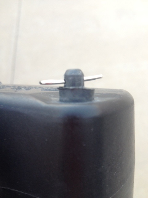

All right,
I've reset the darn pin/spring a couple of times, and I told myself that the next time it happens I'm going to devise a fix (I thought of another way to skin the cat).
I pulled the pin, trimmed the sleeve and then drilled a small hole in the end of the pin. I used a cotter type pin from a button off my old Marine Corps uniform button (thank God I kept some uniforms stuff, even though it's over 27 years old!)
Here's the fix (crappy iPhone pics):
Hope this helps!
