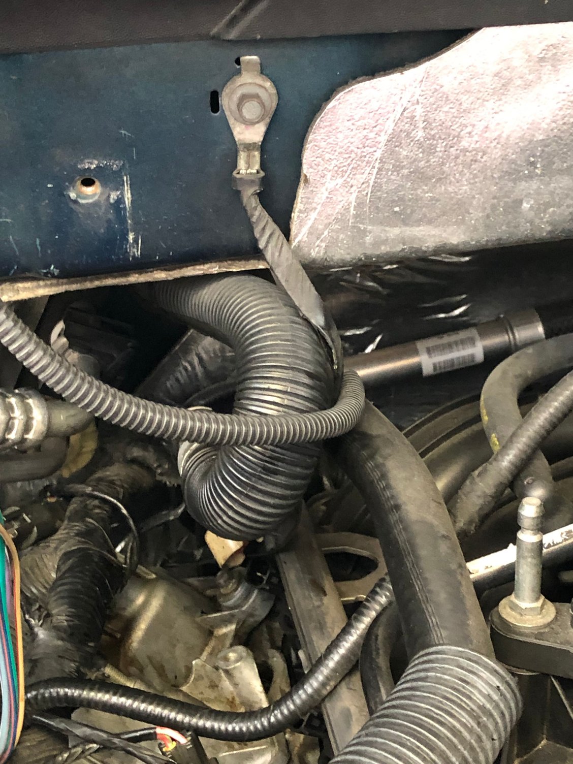

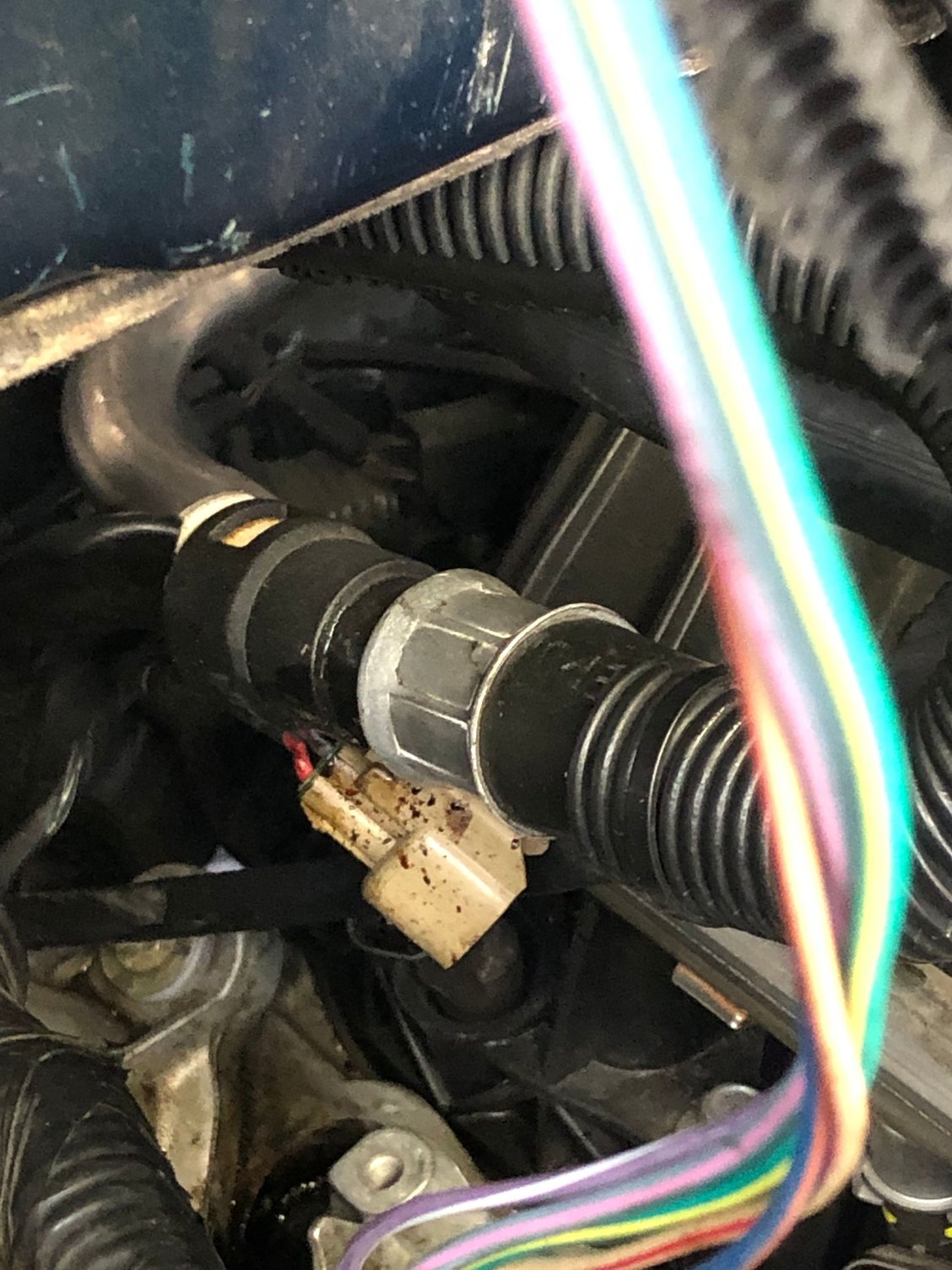

Ok so it is a heater hose
So the heater hose has a very very slow drip at the aluminum connection in the pic.
Has anyone replaced this before? Any how to's or tips.
It does have a quick disconnect too

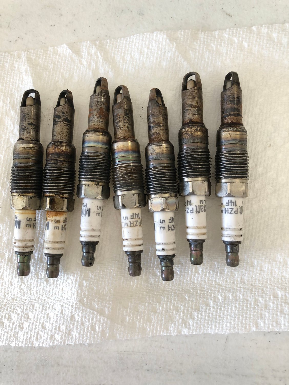

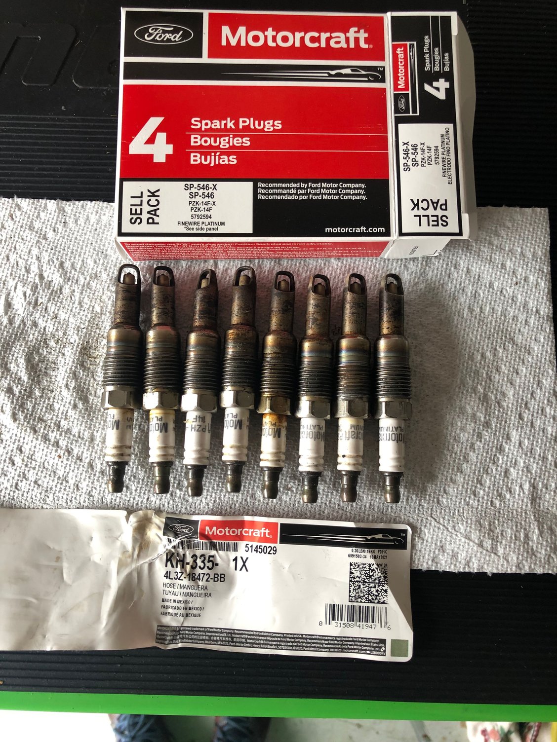

I wanted to follow back up in case anyone else needs to do this.
With the motor cold i opened the pet**** and drain the radiator.
I found 11" long 90 degree bent needle nose pliers works perfect to disconnect the quick disconnect. Just keep twisting and pulling while pressing the pliers and it'll come off. Make sure to take the old quick disconnect off it will stay on.
Putting on is simple.
With this motor still cold I couldn't get my stubby impact in #4 to get the plug out. So I used a 18" 3/8 drive flex head rachet with the otc 6900 and a 3" extension. Came out easy.
Below is a pic of the $48 heater gose on amazon and the most current plugs. They were $125 at auto zone.
Hope this helps.
