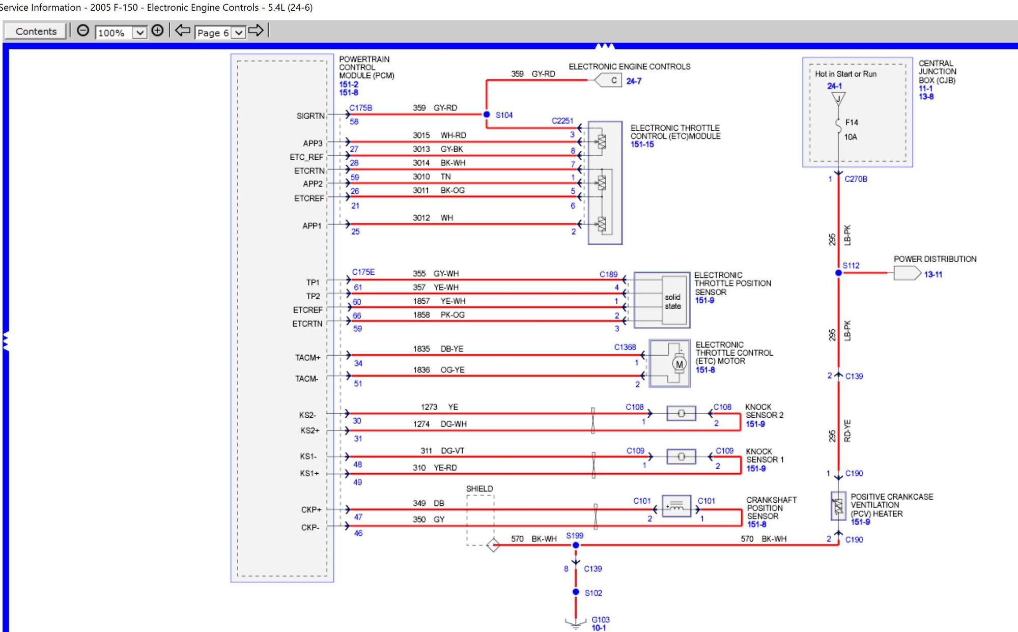

Thanks for the response, could you tell me what MIL is short for? Also could anyone point me in the direction of where I could find a wiring diagram for the crank sensor circuit, I have a feeling its could be a bad wire and not the sensor on this truck

MIL = Malfunction Indicator Lamp aka "Check Engine"
I've got the diagrams but they're on a different computer that I don't have access to at the moment. If no one else posts them, I'll upload it when I can.

Well I got it going again, just needed to remove the crank sensor plug, hit it with some brake clean, then fill it up with some dielectric grease and put it back together. Seems to be working fine now. What a joke of an engineering masterpiece that thing is, hidden behind the ac condenser frame rail and steering rack. Just getting the plug off took a gumby arm and some needle nose pliers. Still if ya get a chance could you put up those wiring diagrams incase an issue pops back up. Its so tight in there I cant tell where that harness is going and if it screws up again Id like to just replace it..
