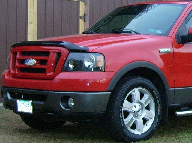

Look at my post, #7 in particular of this thread: Headlights question for y'all - F150online Forums
Other issues brought up are addressed in the thread.
I ordered them in July 2019, I'm still pleased.
I did seal the edges with silicone sealant before installing them, left set to cure a day or so too, even put black duct tape over the silicone to protect it, and I threaded some nuts over the adjust screws to lock against each other to make adjusting easier with a 10mm wrench instead of looking for a 4mm.

Just seal around the edges between lense & housing and use the gaskets at bulbs,but leave the venting open. Just putting bulbs in opens the housings to moist air, if you block all venting, etc, moisture will stay trapped in them.
Occasionally on a cold damp night I'll see moisture condense in the cold lower corners, but because the vents remain, it dries out. That's not a leak.
