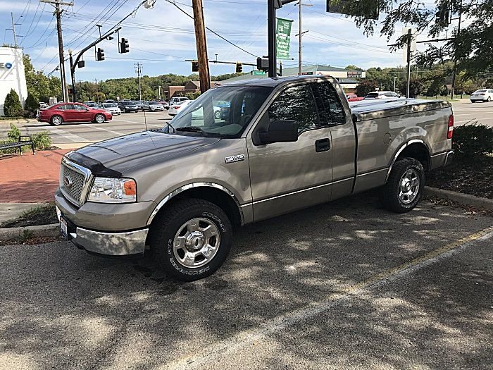

I see conflicting opinions online about which year/engine size/2 or 3 valve, will pop plugs one day, or break off upon removal. 2004 F-150 4.6L Triton, 64K miles. Purchased 4-mos. ago. Really wanted an F-250 4-DR, but couldn't resist the condition & price. Not a scratch on it inside (bed included) or out, and undercarriage is clean.
Any particular undercoating brand I should look for?
I know it would look so much better with new rims. What would you recommend for minimal cost? I'm an older fart, not looking for the sharpest and most expensive. It's never been a work truck, and still won't be. It seems the closest it got to any kind of work, was carrying flowers boxes for the yard.

The 2004 F150 4.6 engine is a 2 valve engine. There is no problem with the plugs. They are conventional plugs with coils on top. The heads changed in year model 2004 which eliminated the issue with the short threads and plugs being blown out of the heads. The only issue in changing plugs in that truck is the passenger side rear plug can be a headache to swap out due to it's buried under the dash. No anti-seize required on the plugs but you will use a di-electric grease on the shanks of the plugs to seal out water.
Your wheels were never popular or well liked. You might find some later year Ford wheels more attractive. I'm a fan of the 20" 2014 F150 wheels that came on the sport package but that's me. You might like something entirely different. Be careful if looking at used wheels. You want to see them turn before buying as a lot of the wheels for sale are crooked and won't run straight. You can't balance and make a crooked wheel run right. You can also buy crooked new wheels so make sure you get to see the wheels run while they balance them. Went thru this a couple of years ago with new wheels on a truck. We went thru 19 new wheels before finding 4 that were straight. The crooked ones, they put back in the box and back on the shelf. Somebody bought them.

You plugs are fine, they aren't going to "blow out", that problem was corrected with the 04+ Tritons. The 4.6L also didn't have the 2-pc plugs like the 5.4L did, so no real issues with snapping plugs off in the head, either. Wheels are personal preference, but your existing wheels look fine on that color. I'm with Labnerd that a potentially cheaper option would be to browse FaceBook Marketplace or Craigslist for some Ford wheels from one of the newer models. Lots of guys upgrade to custom wheels/tires and sell off their factory wheels for cheap.
