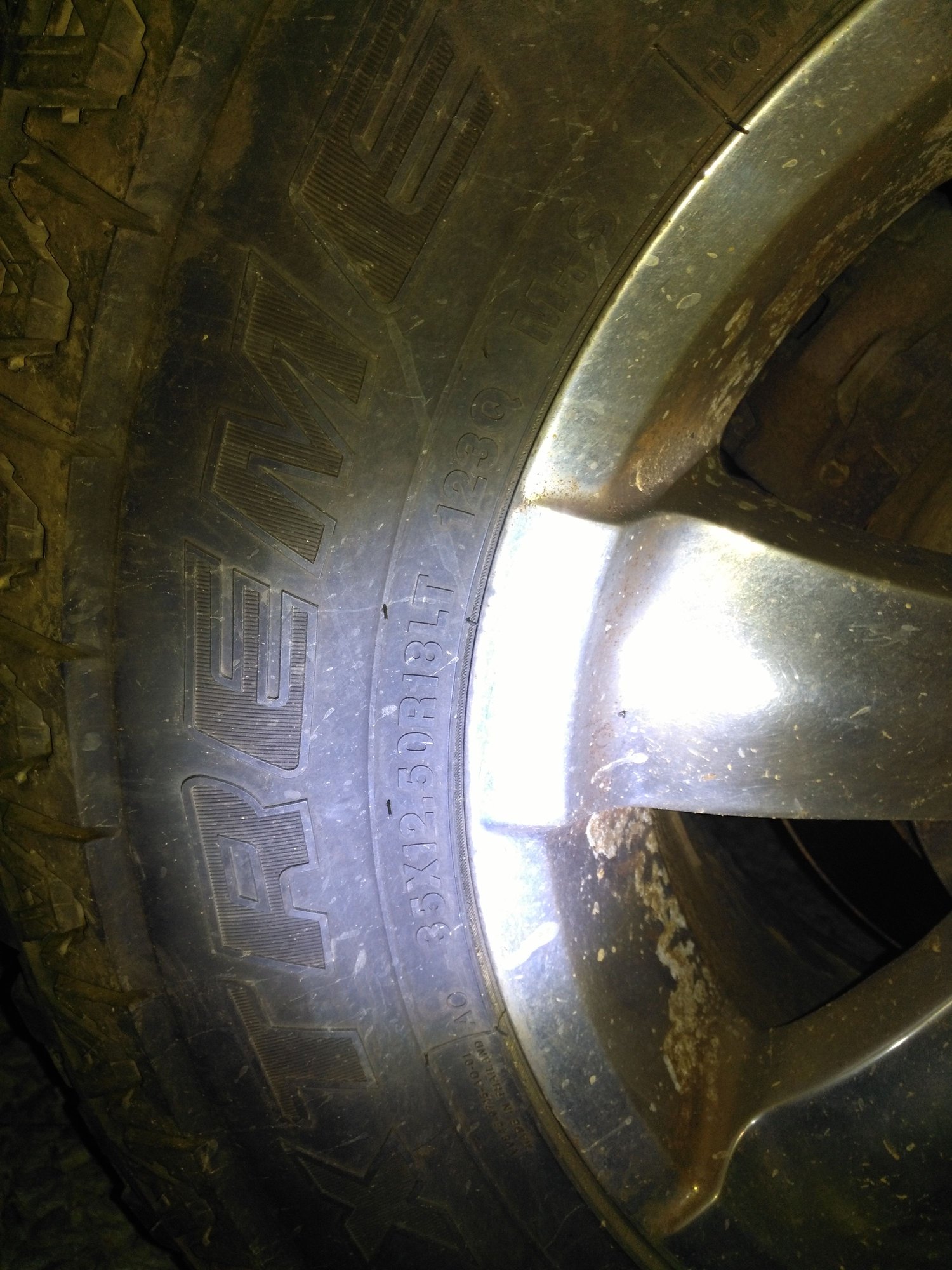

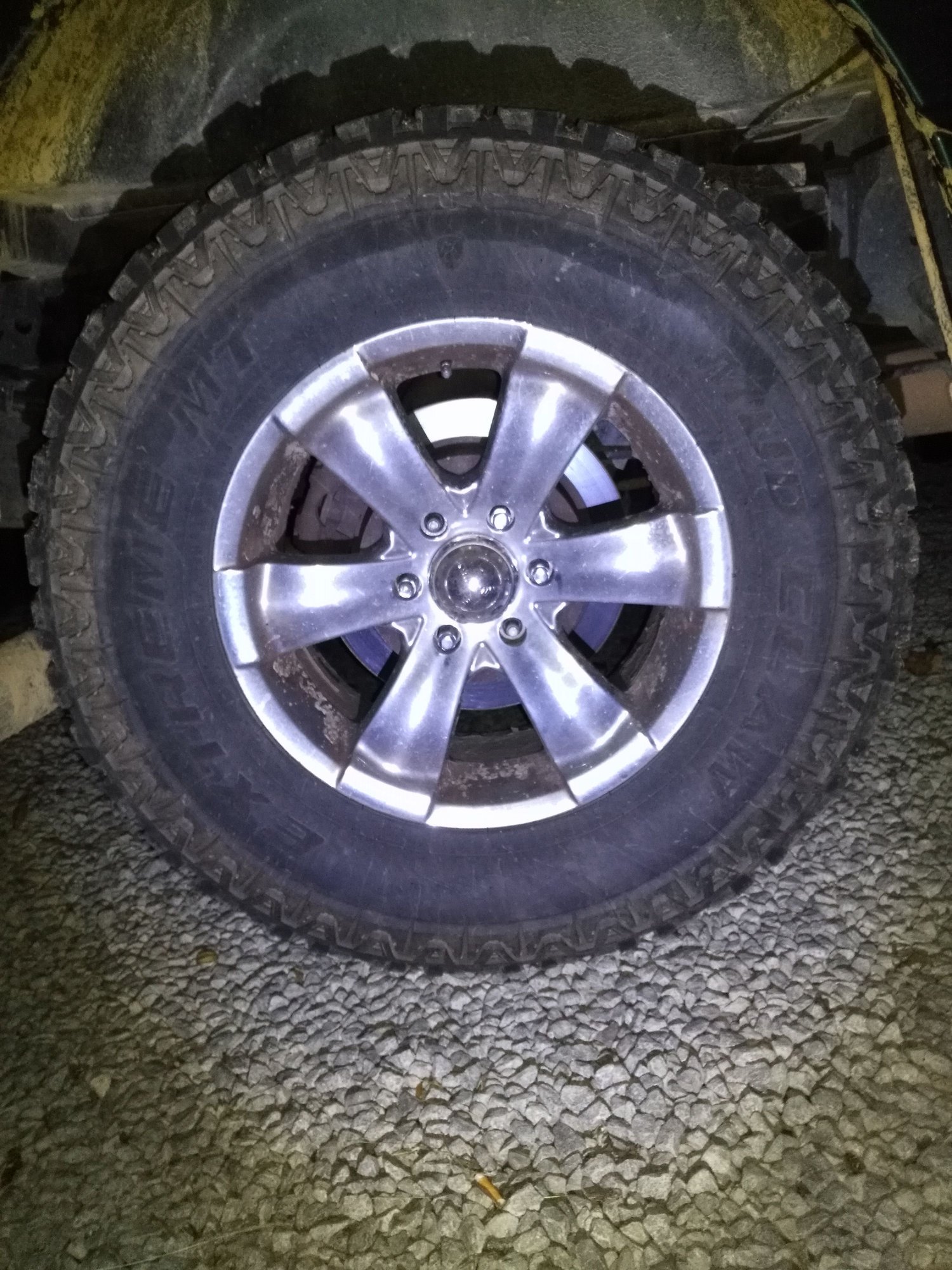

I don't trust my back spacing measurements because I don't know for sure if I'm measuring it right. I can't find any like the ones I have on now. I can't even find out what brand they are. I bought the truck with them on it. I have picture's I will post that are on it now.
Old Nov 3, 2017 | 01:35 AM
Alexis Parsons's Avatar
Joined: Nov 2017
Posts: 7
Old Nov 3, 2017 | 01:38 AM
Joined: Nov 2017
Posts: 7
Originally Posted by Alexis Parsons
this next picture of the tire without the rim is the one I just got. I think it will match the others..it is the same size, so I don't see why not.
