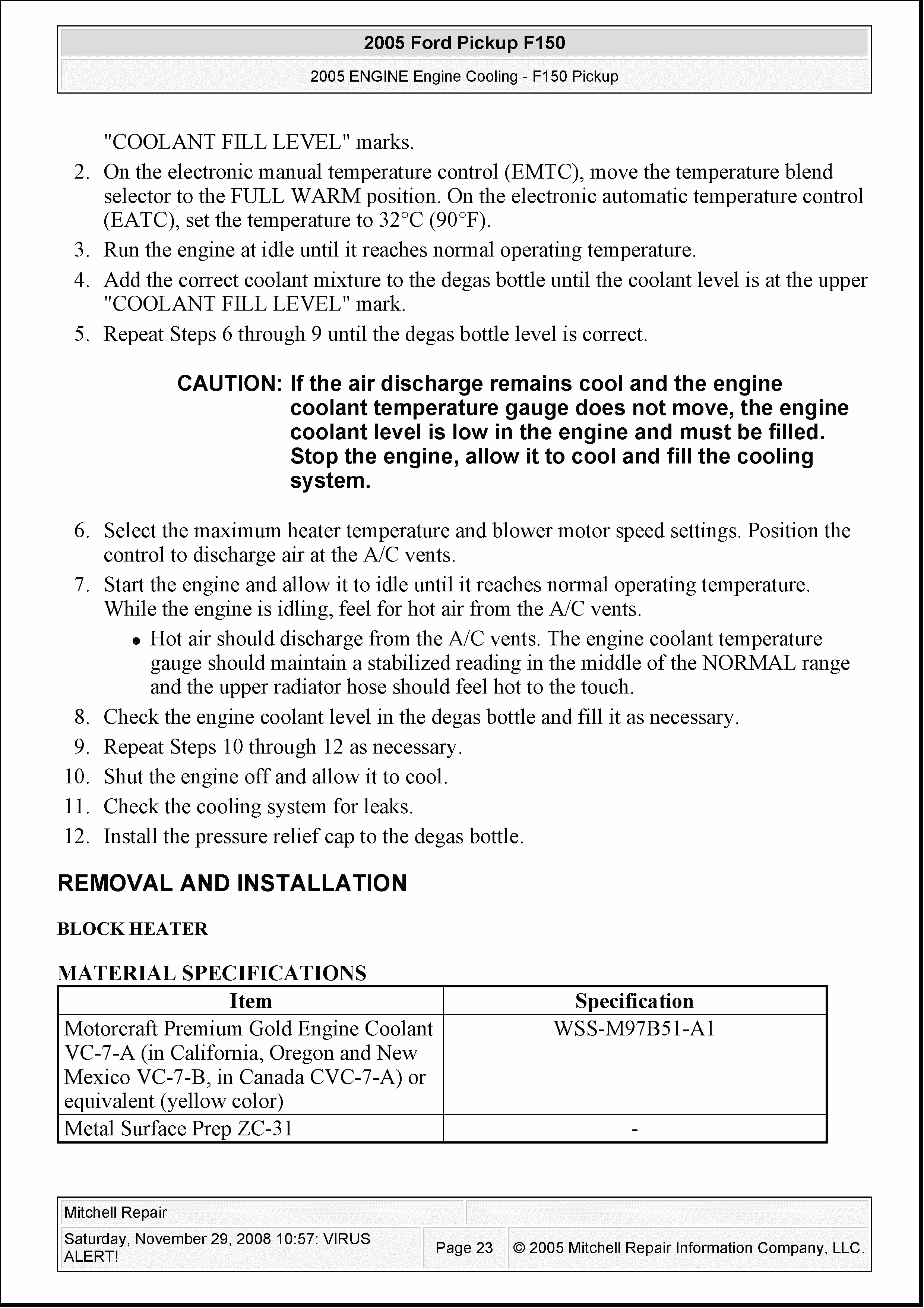

Originally Posted by Ford Truck 07
Neer instructions to flusch coolants on 2007 FORD F150 5.4 Triton 4X4 also locations of Engine drain plugs
The drain plug is on the bottom corner of your radiator. Its a good time to replace your thermostat as well. Good luck!
Attached Thumbnails Flush Engine Coolant-1.png   Flush Engine Coolant-2.png   Flush Engine Coolant-3.png
