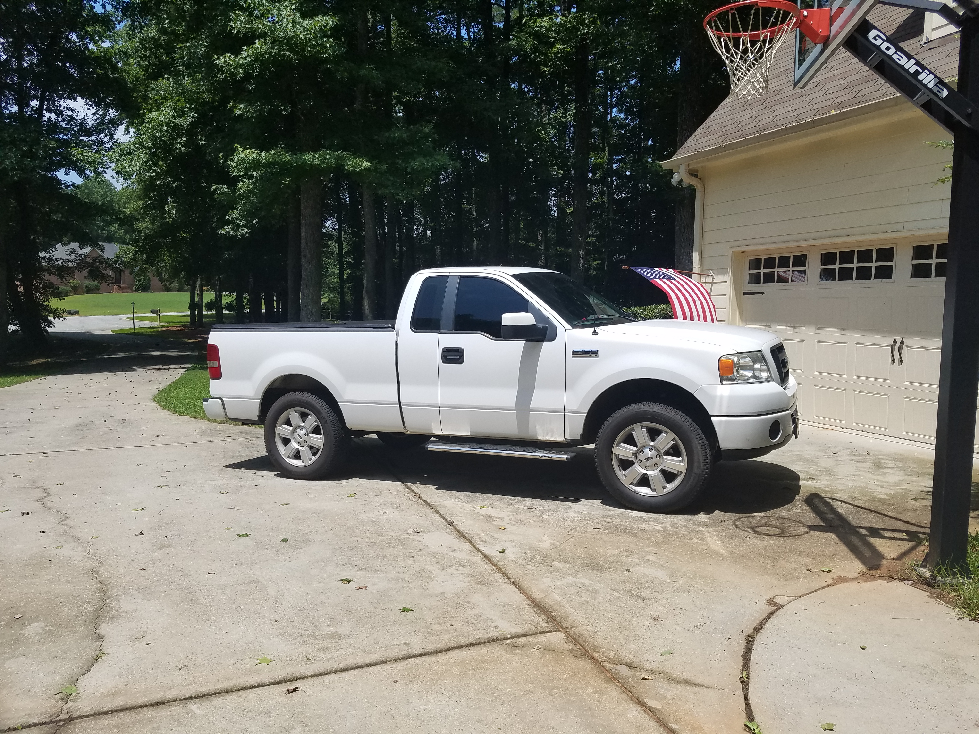

2007 with 2.5 leveling kit, (now has Bilsteins at 2 inch level notch) have a 1 inch rear block. 275 60 R20 Michelin At2.
I didn't do 275 65s bc the majority of the ones I liked were thicker/heavier tires load range E type tires, which equaled up to be near 10 extra pounds per tire. I'm fine with P metrics for excessive highway driving, so I stuck with 275 60 (33 inches).

I like that look. Maybe I'll go with 2"
decisions decisions.
