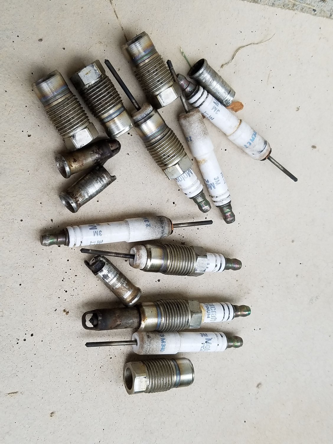

I don't think this is what you would call a successful extraction....
Now what.....????

Looks like a successful extraction to me. With 200k miles you can expect the tip to be burned off.

The tip didn't burn off on the first plug I removed. It came out when the broken ceramic portion of the plug. I was worried because I had read somewhere that the strap wouldn't break when you push the ceramic down. I found out that isn't accurate.
7 0f 8 plugs broke off in the head and I have removed 6 of the broken plugs. The far back plug on the passenger side is giving me issues as I can't get any bite at all on it with the lisle tool. Not sure if my thread is worn or if the shell is stripped out....
