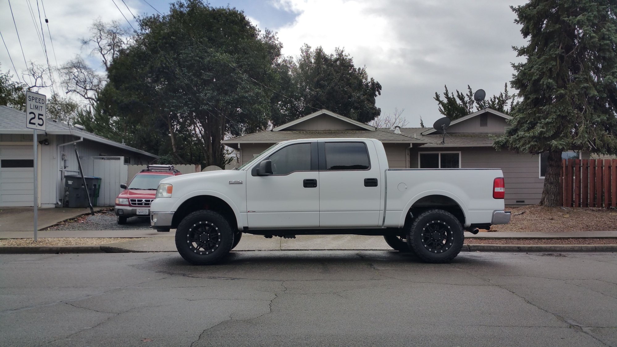

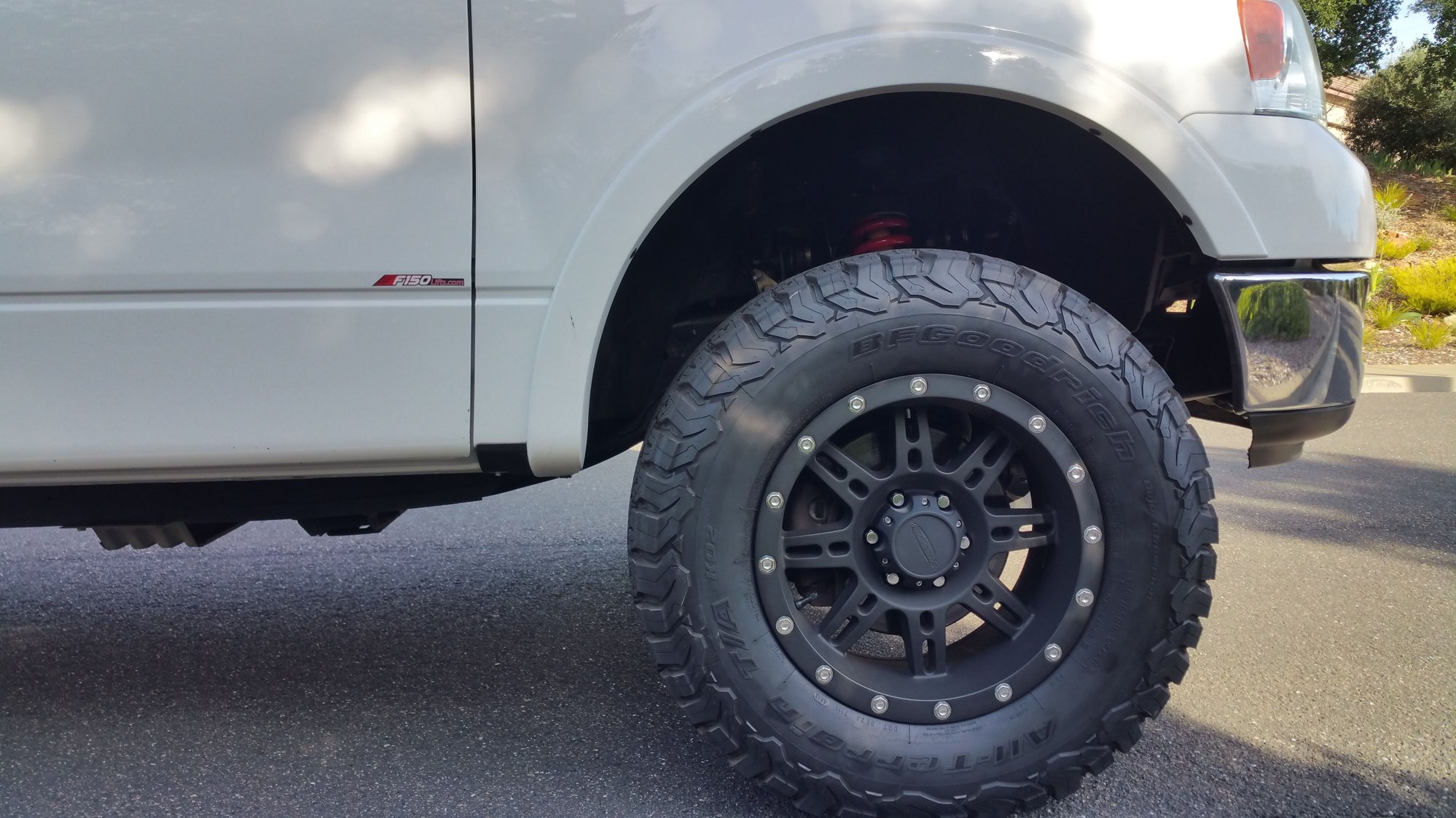

It will fit, I know from first hand experience with that exact setup

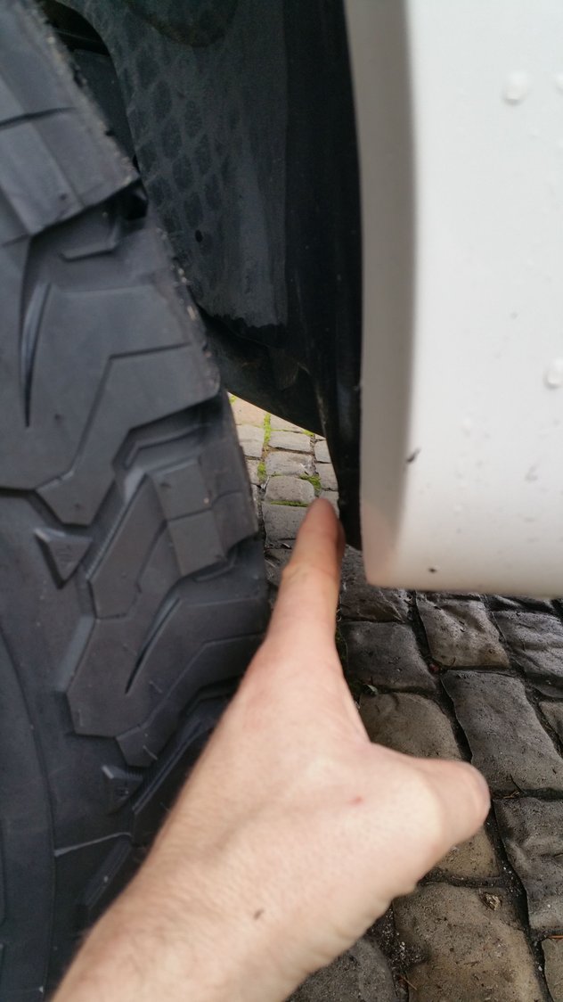

I was told my truck had a 2.5" level when I got it, but I think it was closer to 2. Either that or the OEM Springs and struts were just way shot. I had minimal rubbing on the fender flares and trimmed it just a tad.

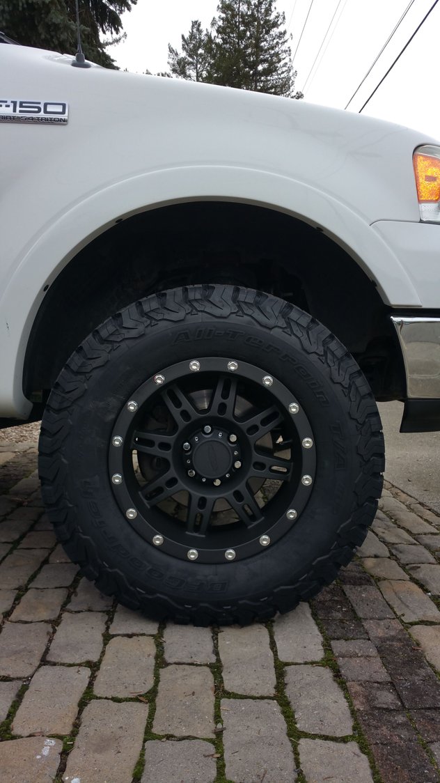

This was before my recent coilover install, you can see the small amount I did on the flare. I trimmed the valance as well.
Pre fender flare and valance trimming, right after I got home with my new wheels

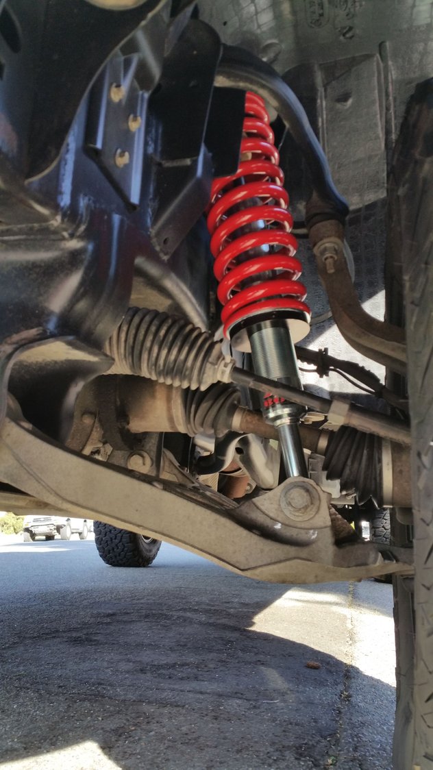

This is after the coilovers which netted me about 2.75" over stock form, if I had these prior to getting the new setup I probably wouldn't have needee to trim at all.
Granted back spacing will have some effect, mine are 5"

Damn dude that looks sick. I think it should be good then. Can you send a few more pictures of your truck? struts and a further away overall view of your truck would be great!

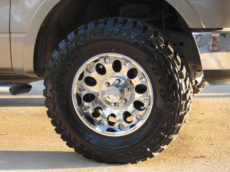

295x70x17 Toyo's (33.5x12) but on 17x9 wheels with 0 degree offset or 5 inches of backspacing. These wheels should be the same as the 18's but one inch smaller in diameter. 2004 Lariat I had that was leveled 2-1/2 inches. No rubbing with these tires and wheels so the 305's on your 18's should be the same.
I had the 295x70x17 Toyo MT's on my '04 Lariat. They were on 17x9 with 0 degree offset American Racing Craters. 33.5x12 and fit perfect on these wheels.

The coils are F150Lifts Boss coilovers, I have a thread I recently made that has more pictures of them as well as my thoughts on them. But for the record, they ride absolutely amazing.

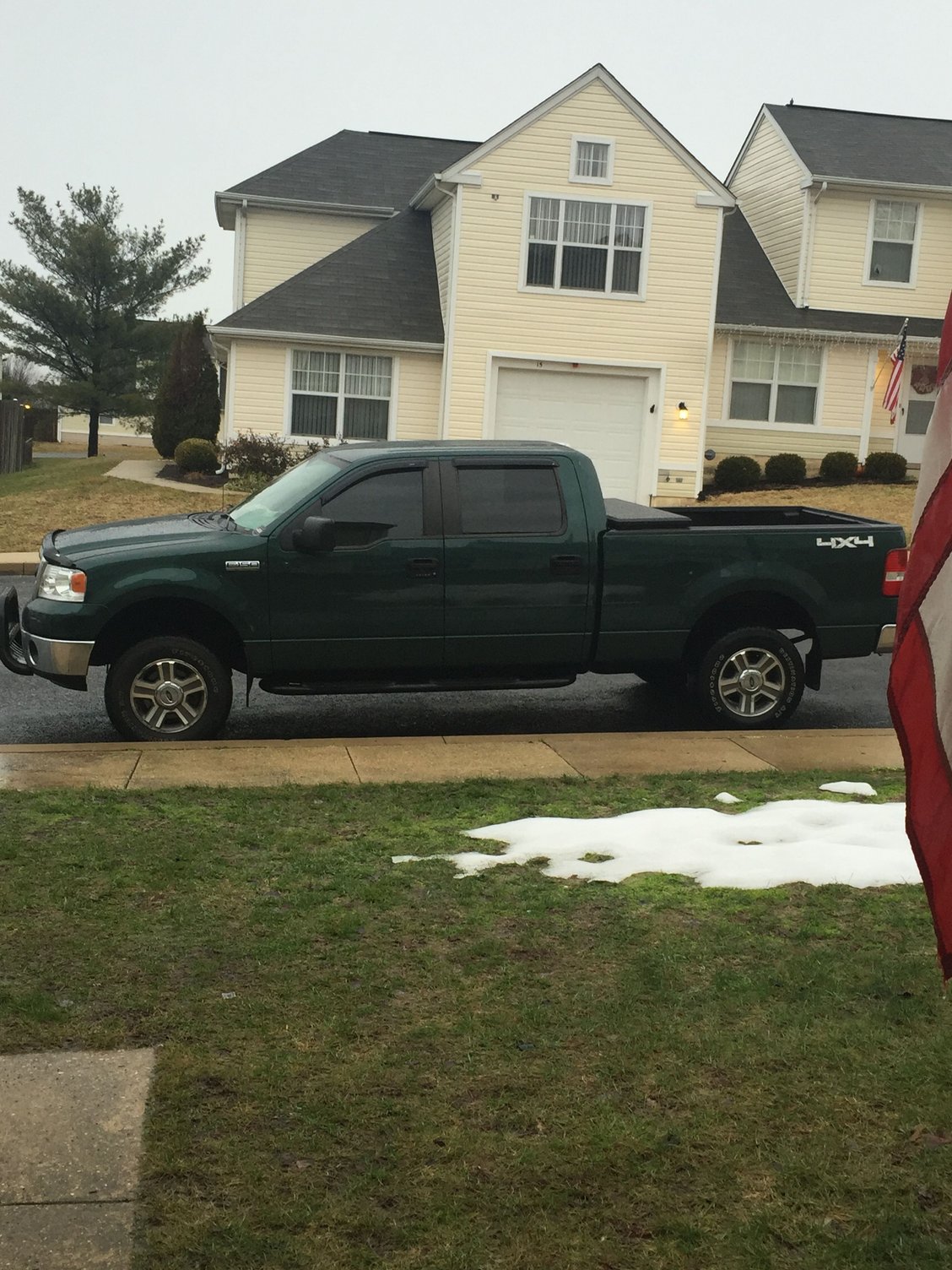

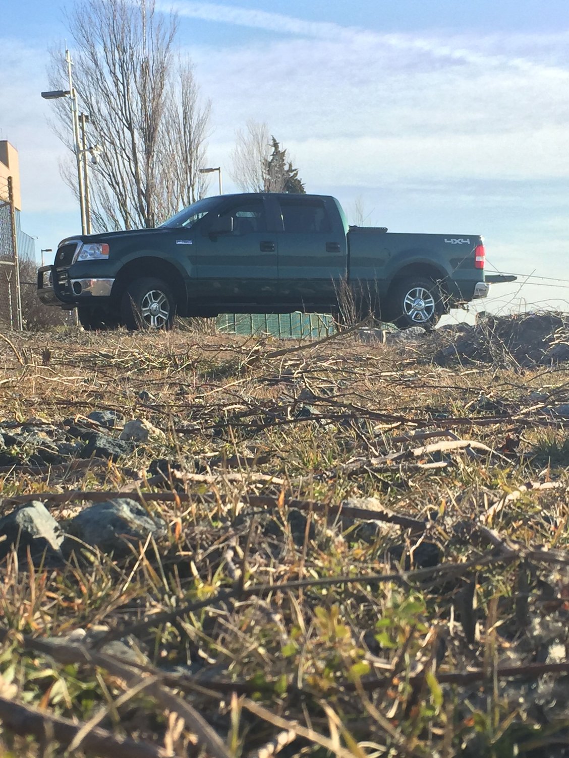

This is my truck

Thankyou everyone for the help

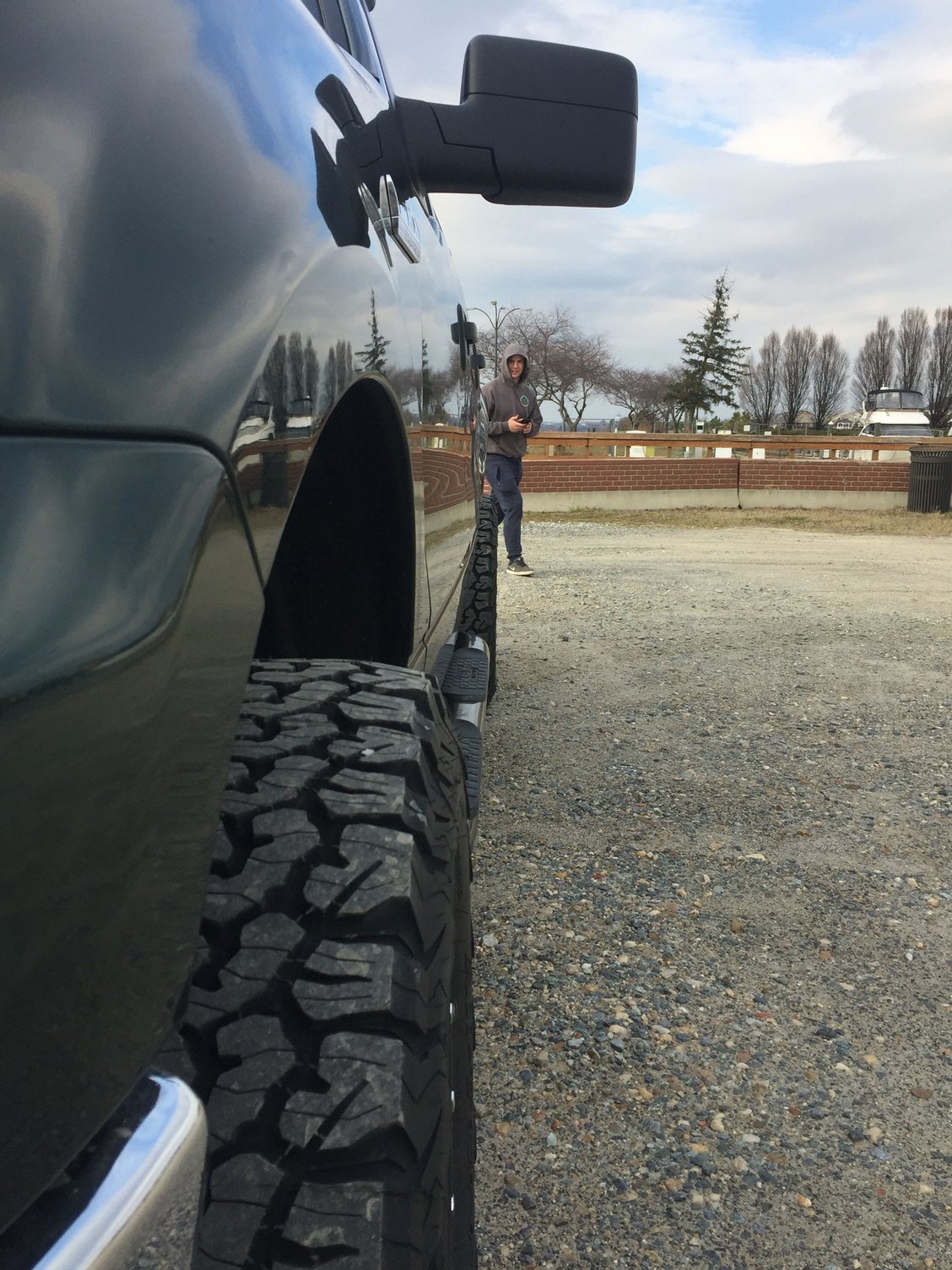

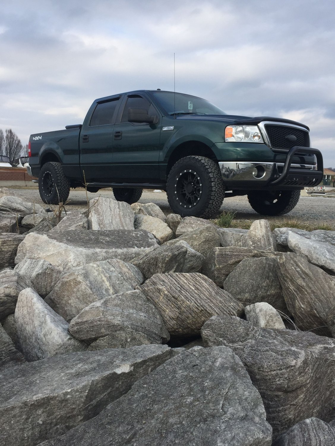

I got my tires and rims put on today, and I couldn't be in more love with it. No rub or anything. 305/65r18 on 18x9 pro comp rims 0 mm offset.
