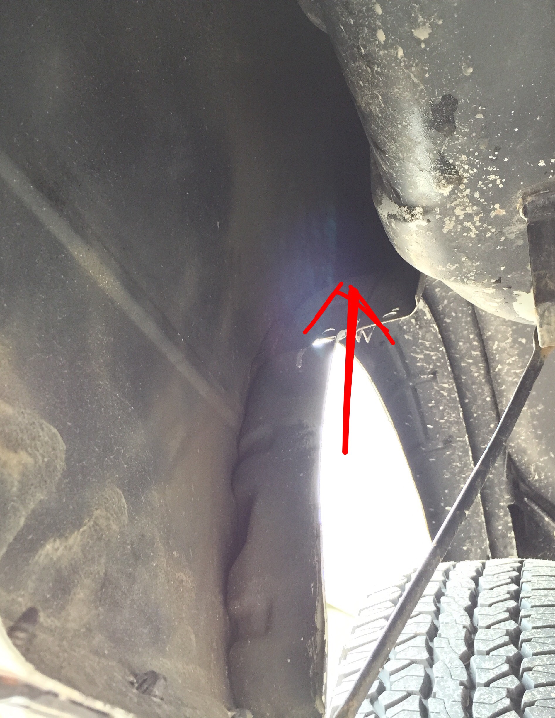

Edit: after re reading, it sounds like this is not a butyl pad issue. I know the foam strip you're speaking of. I keep the entire when wells coated with bed liner. Also, when looking up from under the rear bumper, there's a little gap that I constantly spray out with the high pressure hose. It runs over the top of the inside of the wheel well and the water pores out the other side. I think that's an important trick.

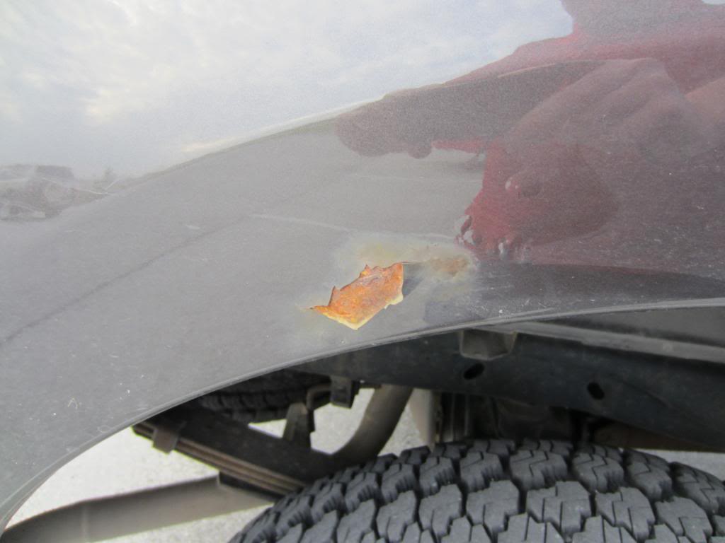

Yeah it's not the pad on mine. The space between the inner and outer wells on mine is pretty clean, the truck hasn't seen much off the road action and when it has I have power hosed it pretty good. There is also no sign of rust anywhere on the inner wells so if I had an FX4 and up the fender flares would completely cover up the rust. A buddy of mine owns a body shop and said he has seen several like this but I have yet to see another one in person. My paint started to bubble in 2012 at only 7 years old
One good part about it is that I'm saving a bunch of time on not keeping the truck clean anymore. I use to wash it all the time and kept a good coat of wax on it. But since the rust started to peel the paint I figure there's no use now.
Here's a picture from last year. Now the metal is pretty pitted too.

I'm sorry to see that! Your frame even looks still nice and black. I think with your issue, it's rusting from above. When blasting the wheel wells, you can't really get to it unless you spray up in that little gap I'm speaking of. That washes out the top side of the wells.
I'll go out and take a pic so others can see.

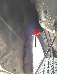

That's the area in speaking of. You really need to spray it out a lot. I believe the rust starts from the top side of the inner wheel well. That opening in the pic goes above the wheel well and exits the other side. I also flood that area with white litheum grease every fall. You can see the remnants of the grease all over the the inside of the rear lower bed panel.
