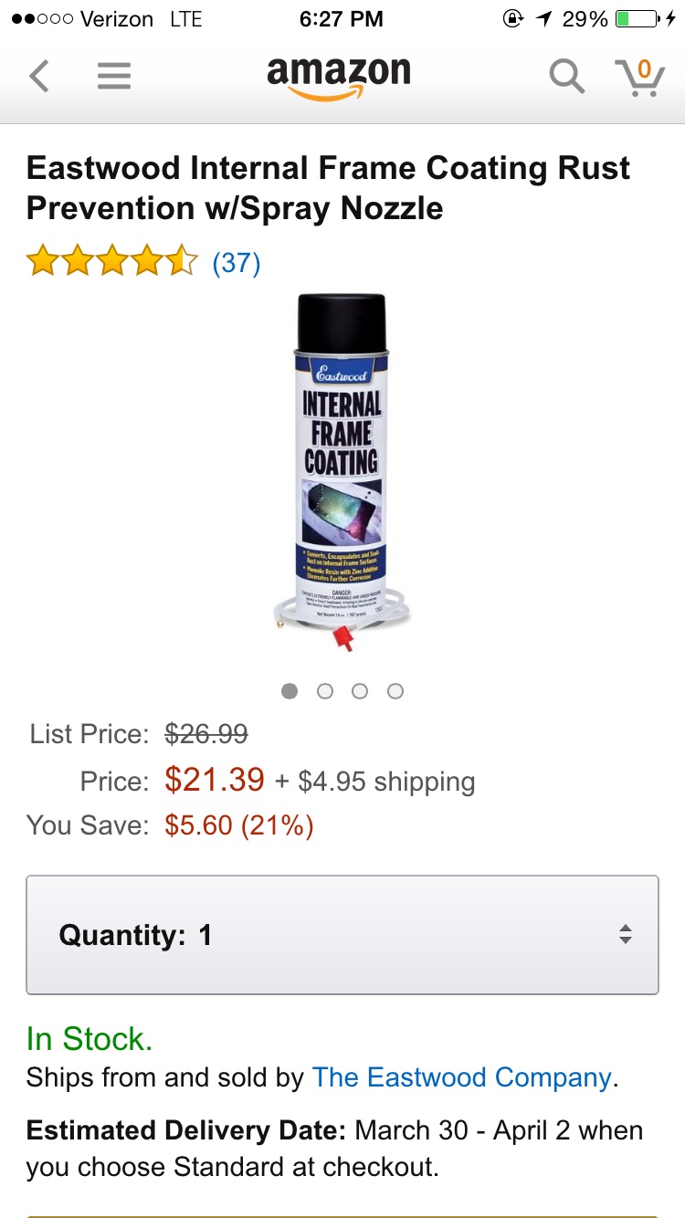

They need to be fully coated. Por 15 outside and try some Eastwood internal frame coating for the inside. Comes with a long tube so you can get it places you could never paint. In the winter, I keep a heavy coating of white litheum grease on those supports.

POR15 and frame coating spray it is, prolong it as much as I can.
