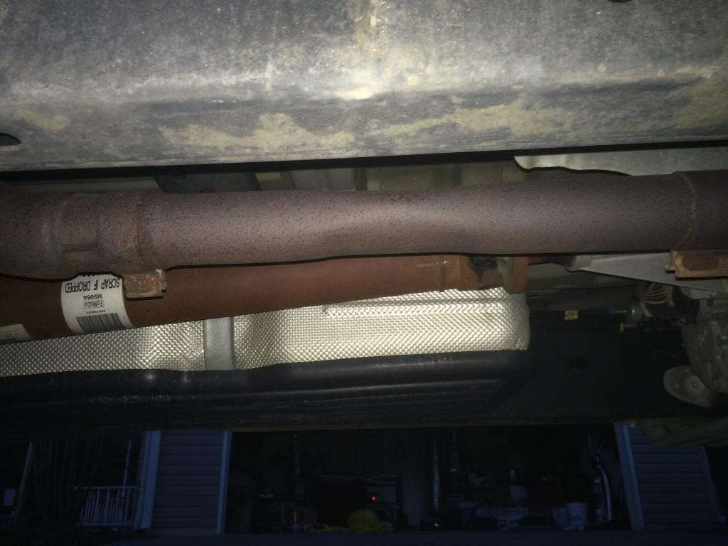

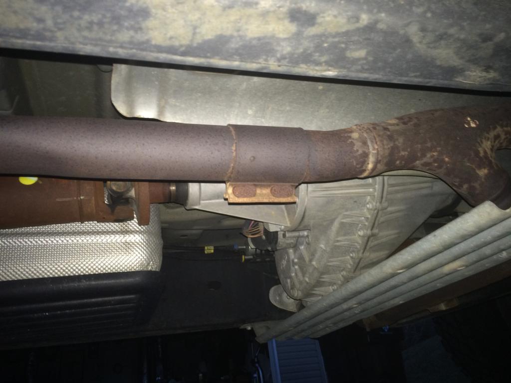

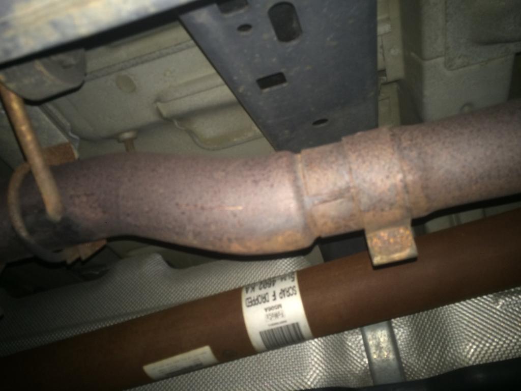

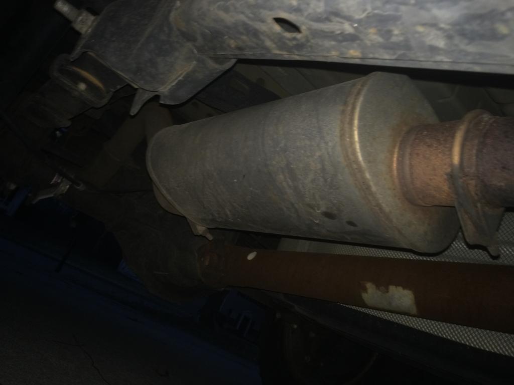

I'm having a hard time deciding whether I want to go up to a 3" midpipe and a 3" I/O bullet, or a 2.5" midpipe and a 2.5" I/O bullet. I took pictures of my current set up. Looks like the stock midpipe from the y and then they stepped it up to 3" right before the muffler. I'm probably making a huge deal out of nothing..... It most likely won't make a difference. Below are my current setup pictures.

Very clean under body, amazingly clean!
You can replace your muffler with the Dynomax in 2.5" and run a 2.5" Y pipe for dual tails, no harm there. I went with the 3" from the Y pipe for the deeper tone it gives, and the milder high RPM power range. If I towed a lot I probably would have stuck with 2.5".

Very clean under body, amazingly clean! You can replace your muffler with the Dynomax in 2.5" and run a 2.5" Y pipe for dual tails, no harm there. I went with the 3" from the Y pipe for the deeper tone it gives, and the milder high RPM power range. If I towed a lot I probably would have stuck with 2.5".
Haha you have to love southern trucks. This one was bought new in east TN and spent some time in Alabama before coming back to east TN. That's how all the trucks look down here. Even though we have had a lot of weather the past three weeks. I'll go with 2.5". Towing isn't an everyday thing for me, but I like to be ready and able ha.
