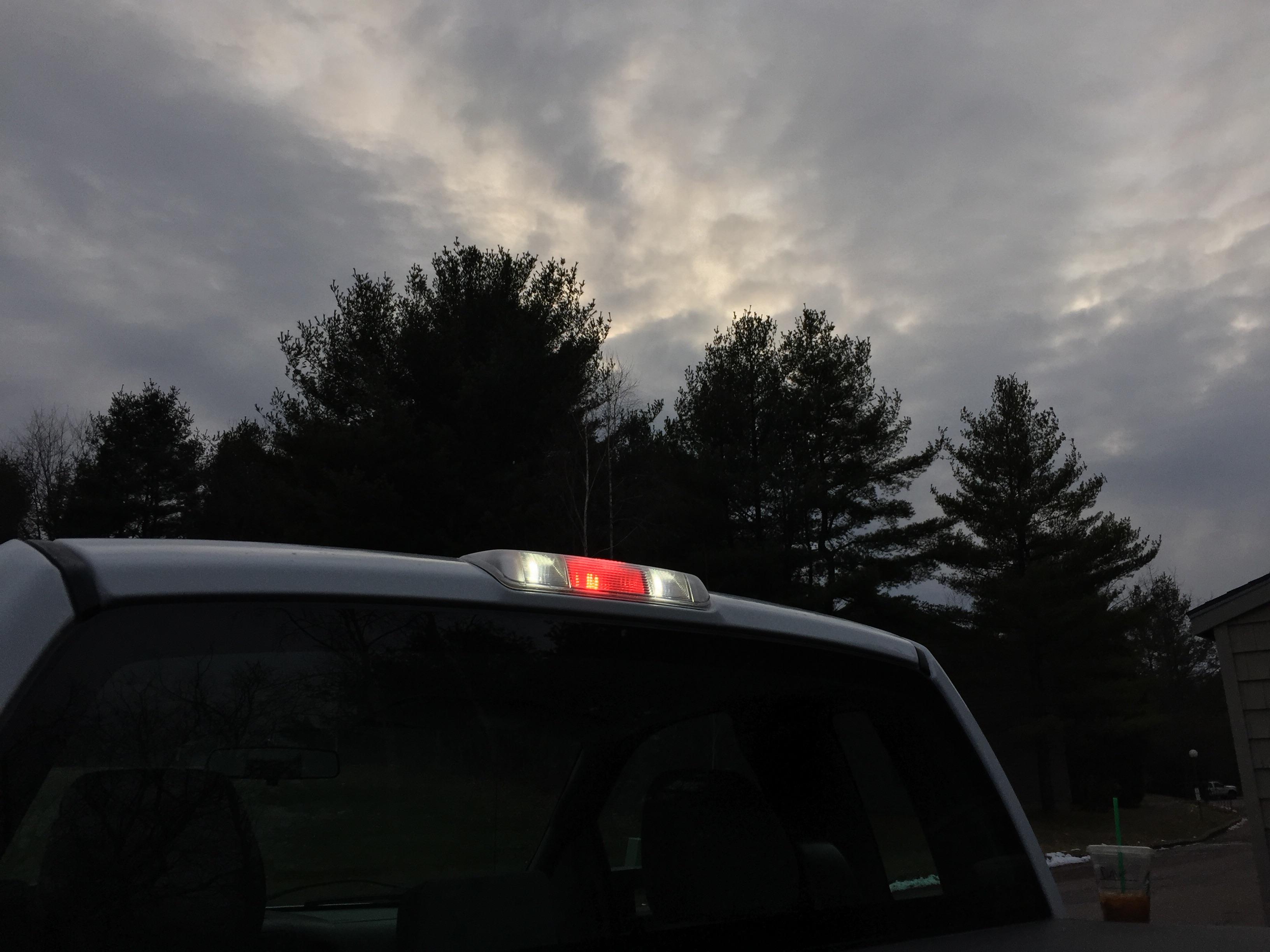

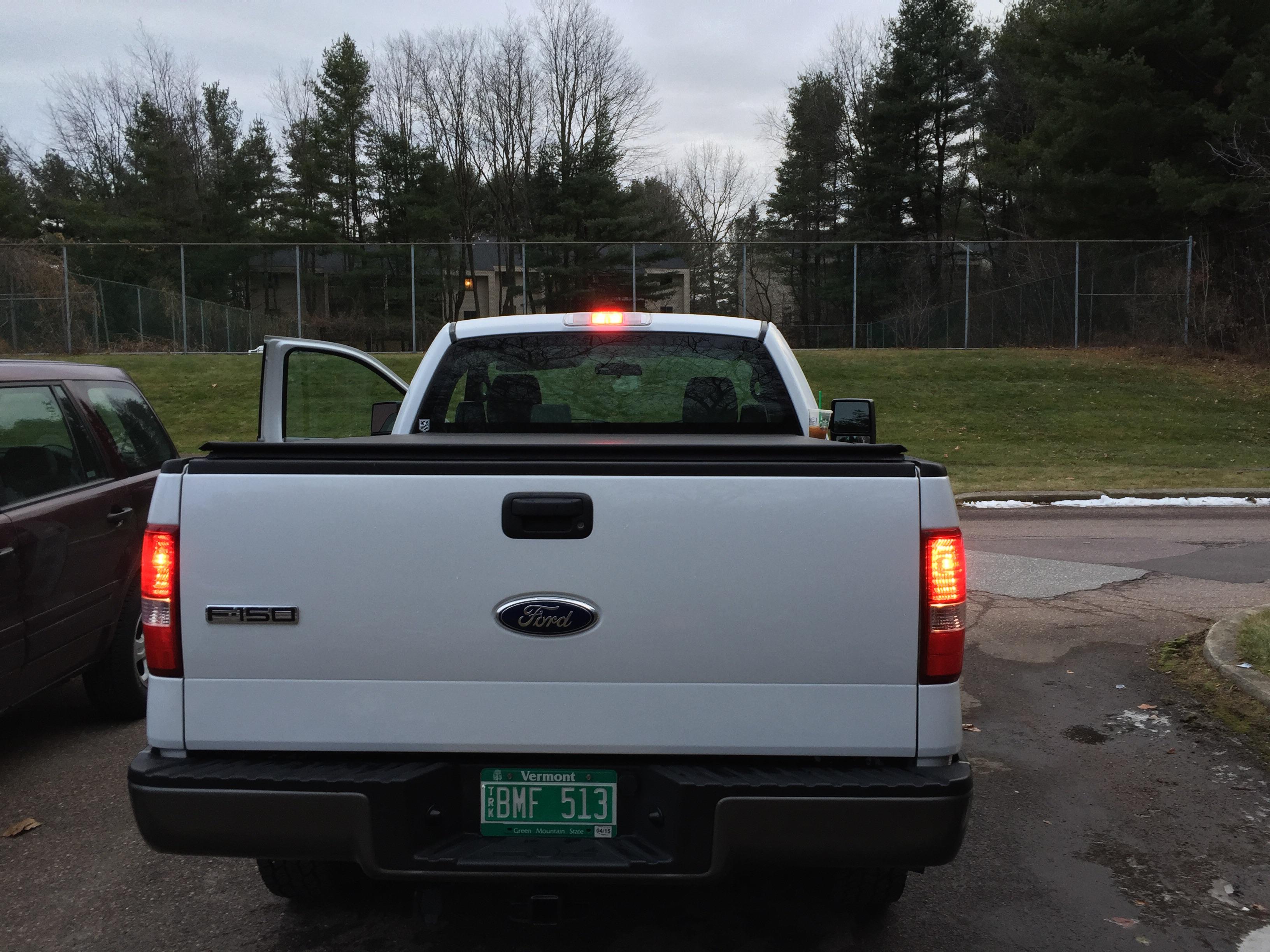

I cracked mine cause I messed with it too much. Bought a used one on ebay that was in perfect shape for $40.
I completely removed the old gasket and used a bead of silicone in its place. Let it fully cure before installing. I learned that the hard way, and that's why I ended up breaking the old housing.
Lastly, put leds in there and you won't have to mess with it again. Just pay attention to lumens and candle power when comparing leds. Put a red led for the brake light.
https://www.superbrightleds.com/more...se-tower/1129/
That's what I used and they're just as bright as the stock bulbs.
I have no leaks at all either.
Hope this helps.
Ps feel free to ask me an unanswered questions you may have. Through trial and error and a lot of messing with the third brake light, I've seemed to figure out what works as far as bulbs and how to properly seal it.
