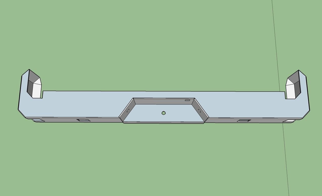

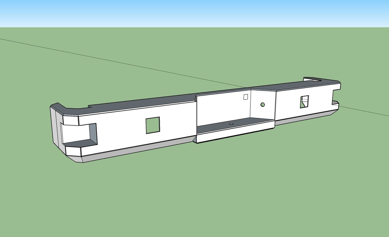

Going to start working on the rear bumper soon. Only when its to cold to work on the front bumper on the truck. This is some pictures of it at different angles using Sketchup. I haven't worked out the brackets to mount it to the truck yet. Only because I haven't looked at how the current bumper is bolted on. Adding brackets later won't effect how the outer shell is designed. Will be made with a mix of 1/4 and 3/16 A36 steel.

looking good.
1/4"? damm you want to lay down tree with it?
it's gonna be HEAVY!
,125 would be plenty enough IMO.

That looks great!
Only thing I would say is shackles somewhere near those lights

I'd rather use a thinner gauge steel and then rub a half pipe brace behind connecting all of it.

Originally Posted by Pockets
That looks great!
I'm going to put shackles mounts on it. I won't know where until I have the mount made up to bolt to the frame.

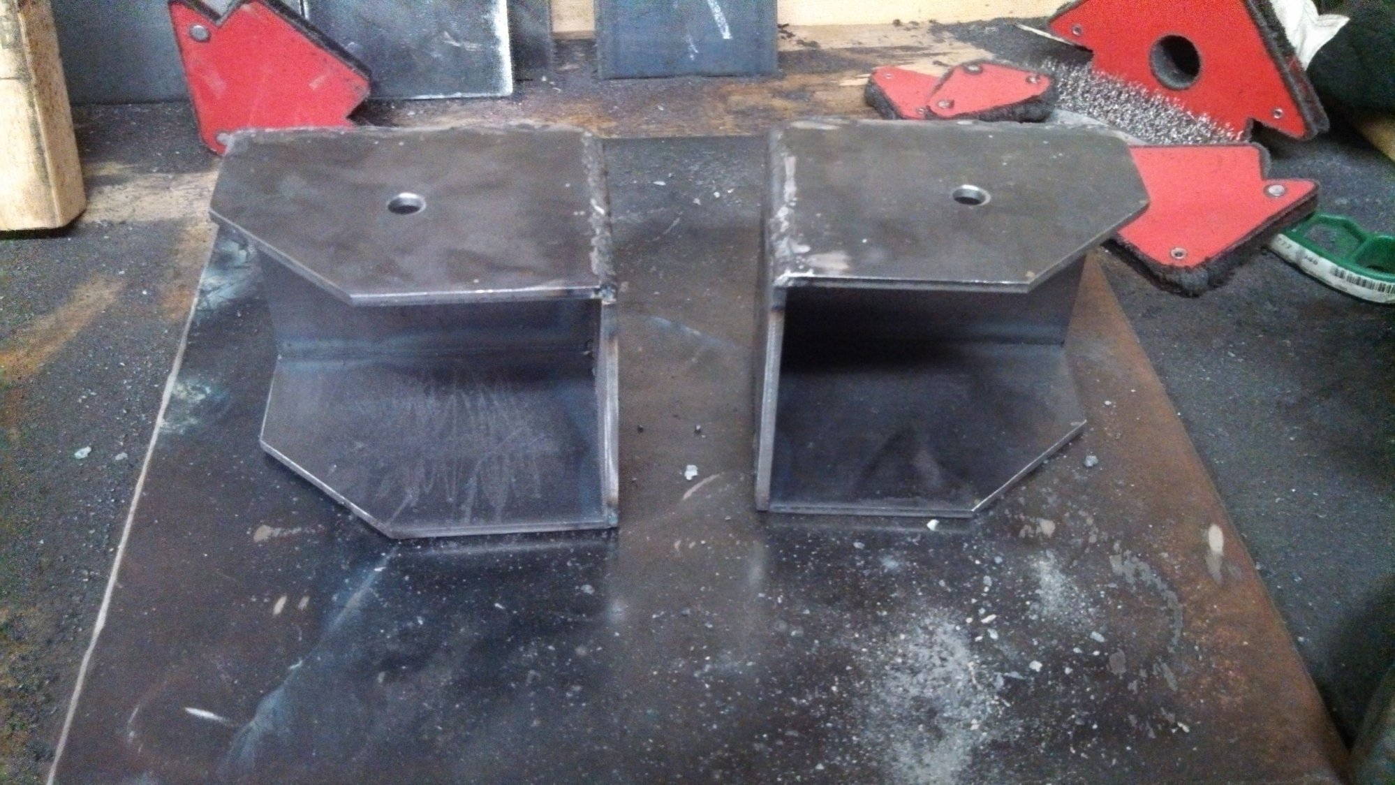

Well it was to cold this last weekend to weld outside on the front bumper. So I started working on the parts for the rear. Here's how the corner step pockets turned out.

Cool starting to make progress! Can't wait to see the finished product.
What's with the little hole on them?
I was thinking maybe he's gonna hang some aux. work or back up lights in them .... protected yet casting some light to sides as well?

cgmiller83's Avatar
Joined: Oct 2014
Posts: 42
From: Indianapolis
The hole is for a light but only a small LED eagle eye. That way you can see where the step is on a very dark night.
That's exactly what I was thinking they were there for!
How about making them red and having them work with the brake lights?
