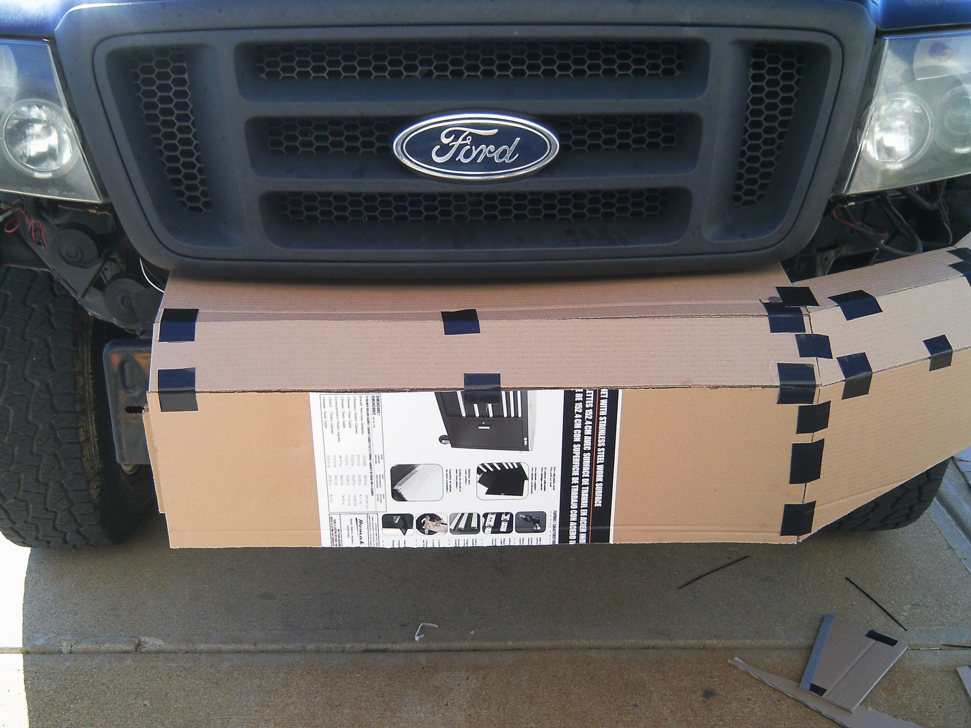

Making progress on the custom winch bumper. Have spend about a month thinking and using Sketchup to make a winch bumper. Along the ever so wonderful cardboard bumper plans. I started using cardboard to get a general idea of what I want to make. Then I switched to using Sketchup, less cardboard cuts!!!
First bumper mount design was a no go.

I'm just hoping that the cardboard one is nothing like the finished one because that gap looks terrible!
I'm trying to upload pictures of my bumper from TAG. But the bumper goes right up to the headlights and looks great, please say you are doing this.
Its going to go right up to the headlight.
