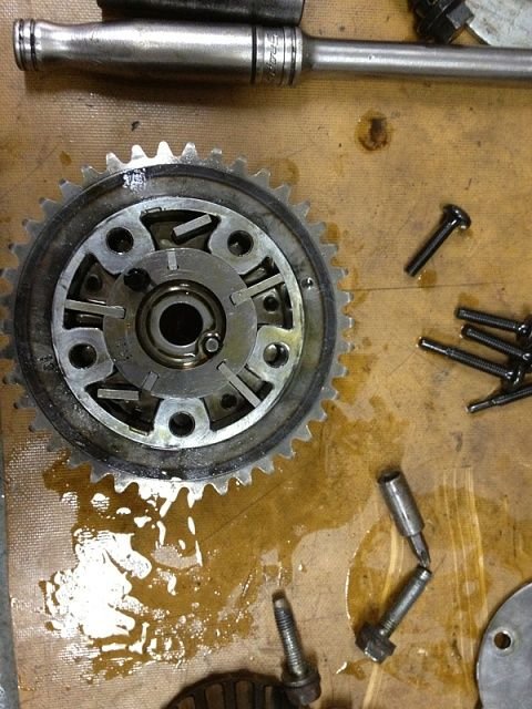

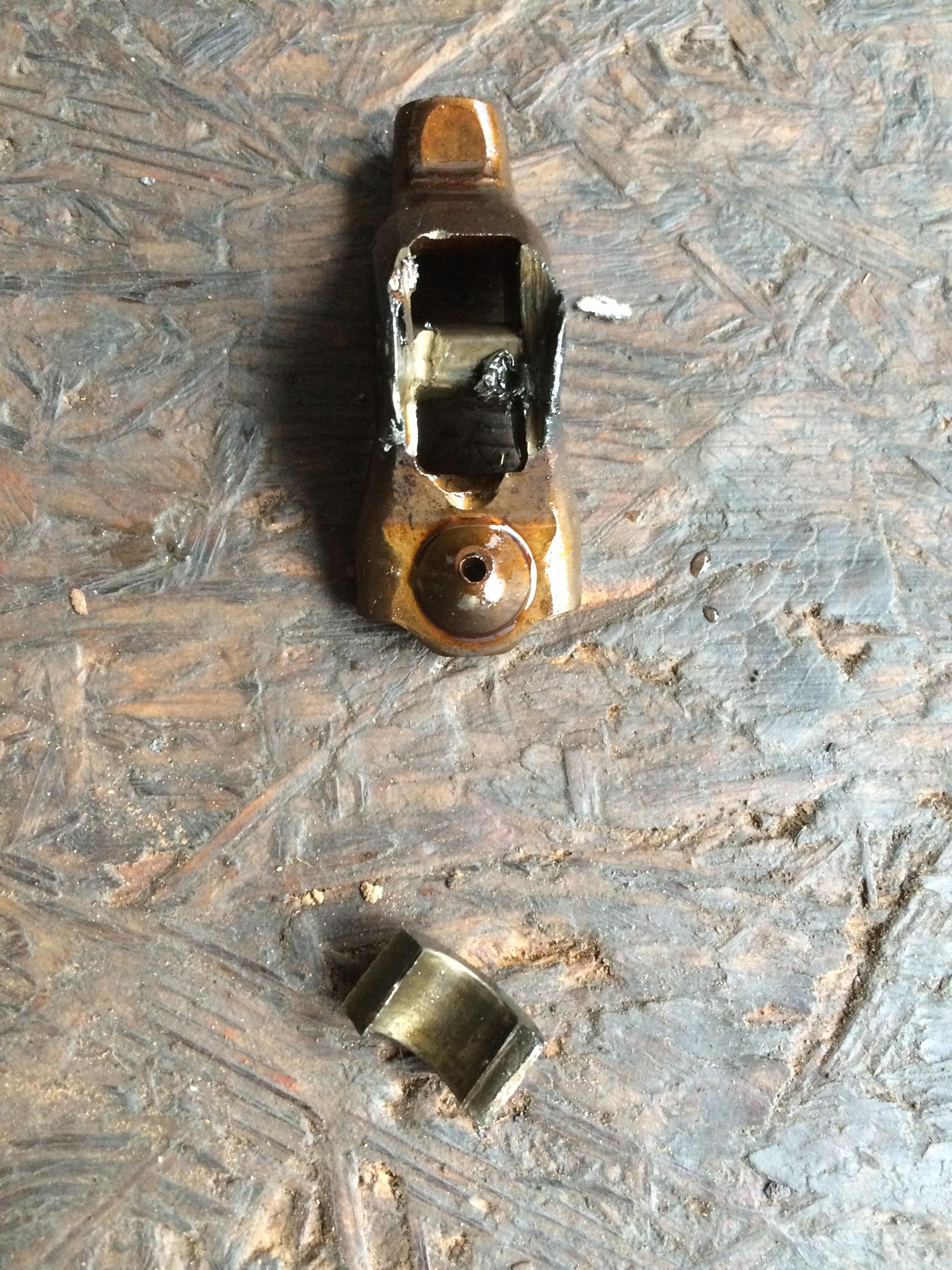

Yer just one follower away from this:
https://www.f150online.com/forums/v8...4l-3v-problems.
I'd change 'em.
